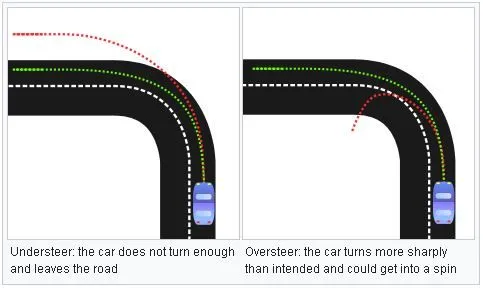

If the front tires break loose before the rears, you get understeer. If the rears break before the front, you get oversteer. Understeer is easier to correct compared to oversteer, thus it is the safer option. That's why all tire repair shops and tire manufacturers will always recommend that a new pair of tires always goes on the rear.
The spare is a totally different scenario. Because the spare is smaller in diameter and in width, the safe handling characteristics of the car are severely compromised with the spare up front (vs. a more worn tire up front that simply provides less grip). Also, most drivers with common sense understand that you should be driving more carefully/slowly with a spare tire on your car, so the issues with understeer and oversteer are much, much less likely to be a concern.

If you are understeering, you simply ease off of the throttle and apply light braking as required to regain control. If you are oversteering, you do the same thing, but you should not be braking, and you have to counter-steer to correct. When counter-steering, it is very easy to over-correct. Thus recovering from understeering is much, much easier than recovering from oversteering.

Yes, I disagree with your premise. I'd rather have to correct oversteer [possible to do with the steering] than to correct understeer [not possible with steering, but only with application of rear wheel power which most cars can't do, or a reduction in speed].
Hydroplaning is a complete lack of traction, no control. Understeer and oversteer imply partial traction, with ability to correct.
And for a complete loss of traction, I'd rather lose it in the rear, so that I can continue to have steering input. Without steering, you're an unguided missile.

Correcting oversteer might be easier for you or me to understand and put into practice. But when it comes to the general population, most will over-correct and put themselves in danger. Correcting understeer is easier because in the event that a driver loses control of their vehicle, their immediate instinct is to slow down. If you hit the brakes while understeering, your front wheels have an opportunity to regain traction. Worst case scenario, you don't turn and end up going straight. If you hit the brakes while oversteering, you lose traction and it becomes even harder to correct. If it's easier for you, that's great, but it doesn't mean that the general population would react the same. I think that's why the thinking has changed, and it's why shops and manufacturers recommend what they do.
