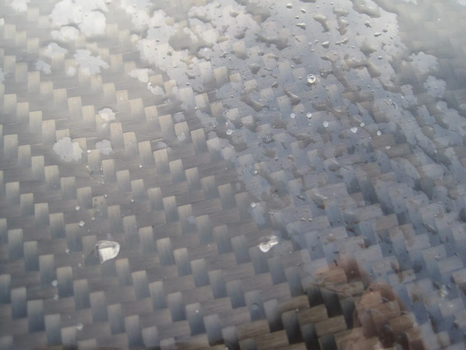

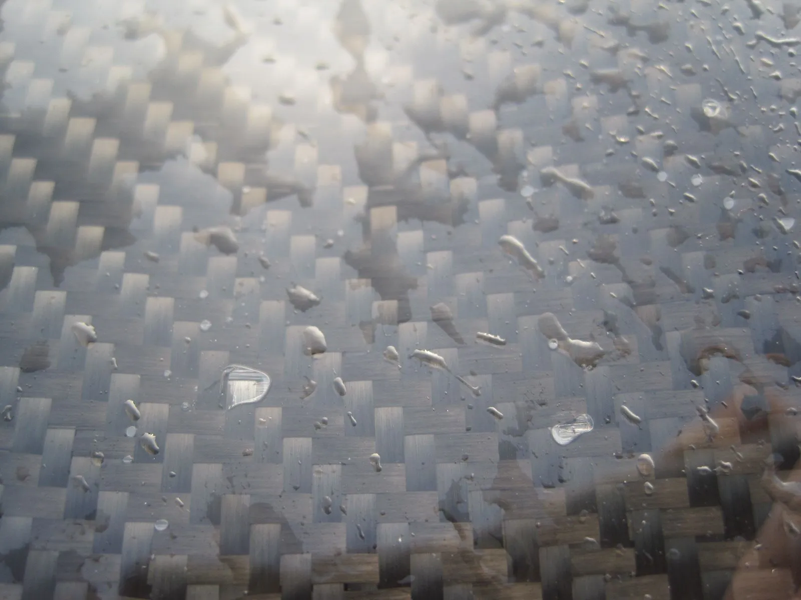

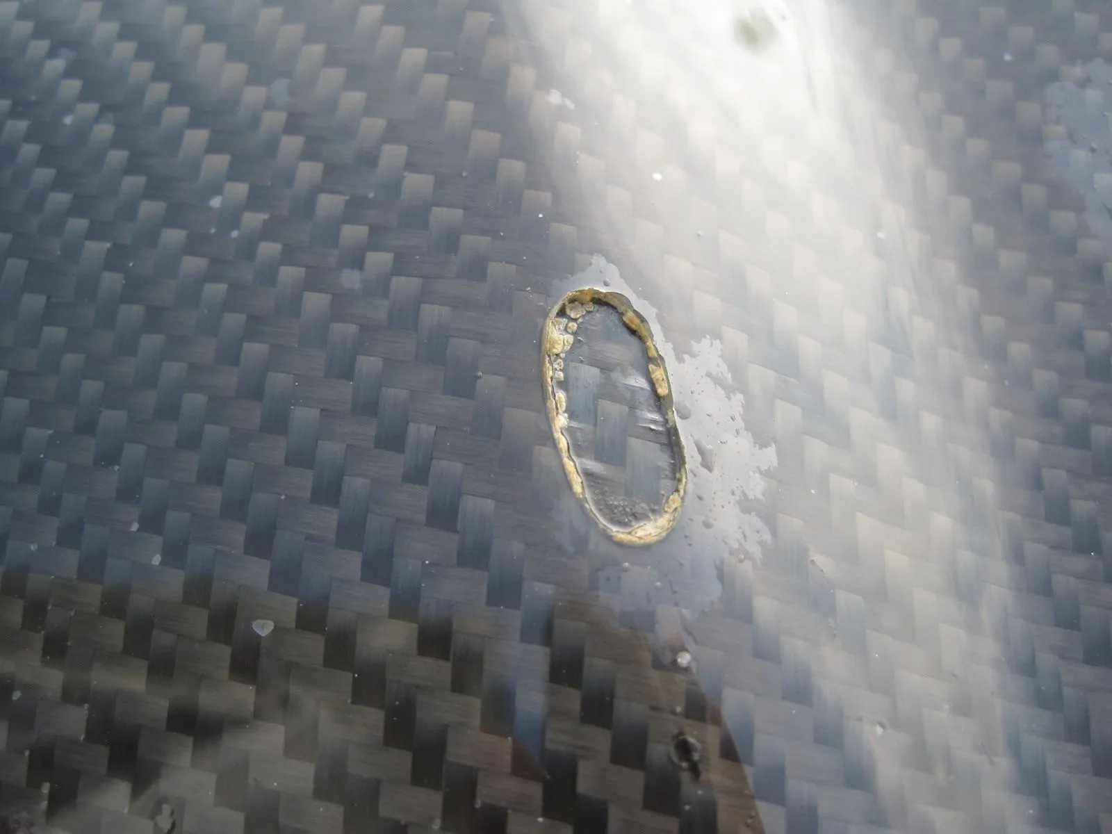

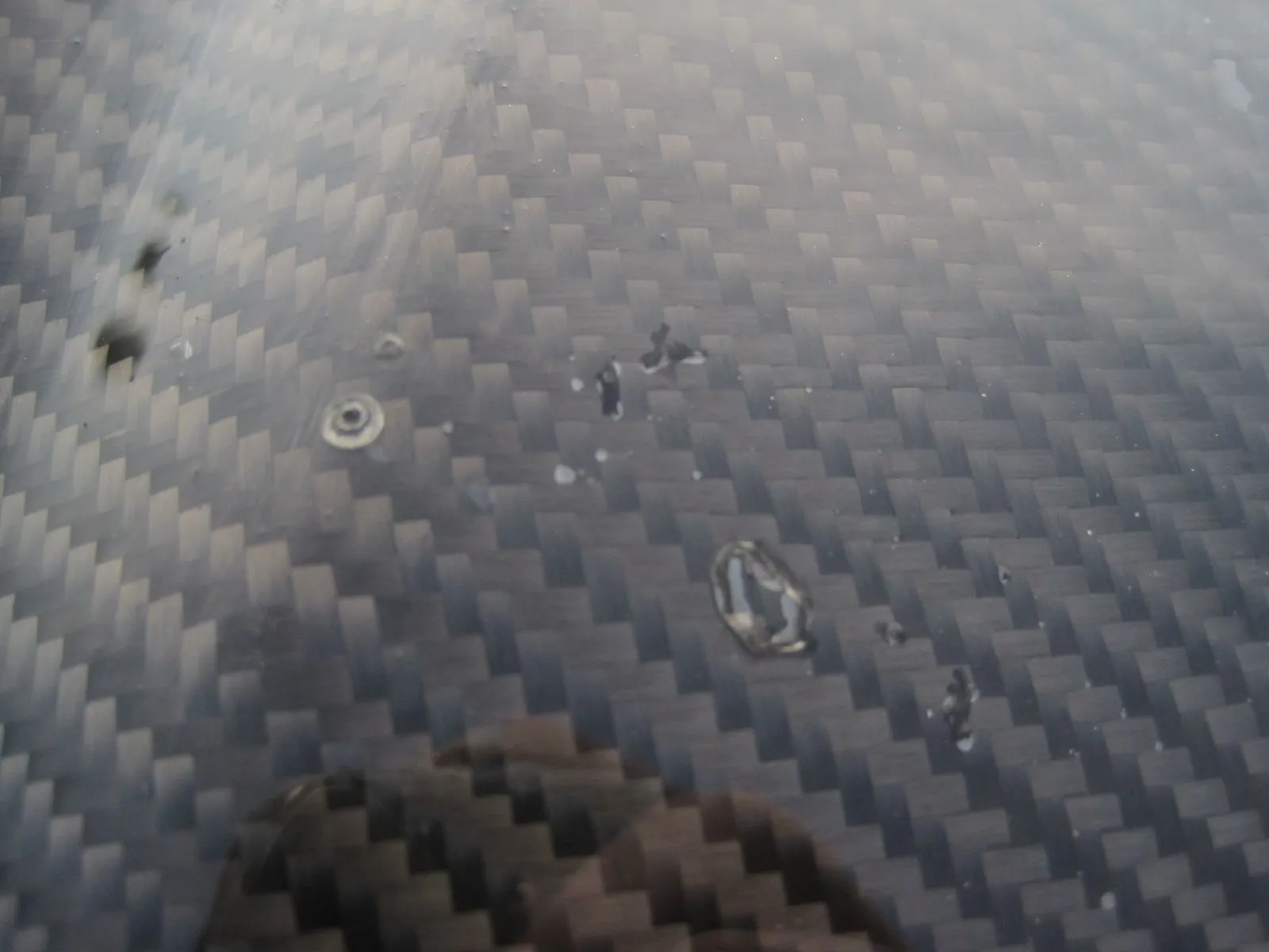

I'm needing to find out how this can be fixed. I bought a hood from Xcelerated Concepts a few months ago. When it arrived it looked okay, despite a few air bubbles under the clear coat. I was not aware this would happen, so I emailed the company and they basically said to deal with it myself, that this happens with the way that they clear coat the hoods and they weren't going to do anything to help me out with the issue. So now, there are several bubbles that have reached the surface. One of which has cracked all the way through, so that piece of clear coat is currently missing, and there's a hole in my hood from that. This sucks, I'm definitely not pleased with this at all. Of course would I have known this would happen with their hoods, I never would have bought one for that much $$. There are a few more that are coming to the surface as well, so I'm really wanting to know if anyone knows how to fix this. Would I have to get the entire hood redone?
um there really isnt any way to just fix it, u would have to have the bubbles sanded out and then re-clear the whole hood
my hood did this too but only on the right and left sides so i sanded them out and painted the sides body color
are the edges of ur hood rolled or cut? mine were cut which was making me think that air could get into the weave that way when its hot or cold and expand, so i made sure i cleared the edges really well to seal in/out the air
I'm not too sure about the edges, they look to be sealed okay. If redoing the entire hood is the only option to fix this, that pisses me off that I paid that much for a hood yet now have to put more money into fixing the problem caused by the company that I was unaware of prior to purchasing. If air bubbles are a major reason all other companies shy away from clear coating as stated below, why do they do it? I never expected to have to fix issues, and get a little more pissed every time I see a new bubble rise to the surface. Definitely not a quality hood as I thought it would be.
"Hi,
That's unfortantely one of the downsides of providing clear coating and a MAJOR reason all other companies shy away from offering it. You are exactly right, it's an air bubble that has come thru. It's due to the carbon material trapping the air.
It's a pretty simple fix. Is the bubble completely out? Meaning can you feel the edges on it? If it is, you can just use a bit of clear on it to fill it. If it's not out, the area can be wet sanded and then touched up.
If you need any more advise on fixing it, I can get my shop guys to look at the pics and give some input. I think it just needs some clear touch up personally, and you might even be able to do it yourself it you feel comfortable doing it.
Joe"
The issue now is that there are a LOT of air bubbles still under the surface. After watching the others for several months, and watching them rise to the surface, I can only imagine that the others will do the same. I attempted to fill in the large bubble that first appeared, but it was uneven when I attempted it, and was not level along the top as it should have been, so apparently that fix is out. Blahhh.. how much does it usually cost to redo a hood?

Xc hoods and trunks are rolled,
but there's not much you can do, my trunk I got from them doesn't really have the issue, the bubbles are from when they vac bagged and didn't do it long enough to suck it all out.

Talked to several local body shops, nobody wants to touch it because the bubbles go all the way into where the CF starts. One shop suggested filling in all the holes with epoxy as a "patch job", but they said that it still wouldn't look how it is supposed to look. As of right now there are NO options to sand down and clear coat the hood again, so my other option is for it to be painted the color of my car but I'm not too sure of that because of how the gel coat/clear coat is thicker on the top of the vents than anywhere else so I don't want to lose that angle. Are there any shops that COULD do this? Do I just need to keep looking for one?
I had the same problem with my gemini hood yesturday. My buddy wet sanded it & I picked it up today. It looks great! But mines was only 1 area of the hood! And he never messed with cf before.

the last pic u posted is how mine looked on the sides, i thought they were rock chips but i guess not
