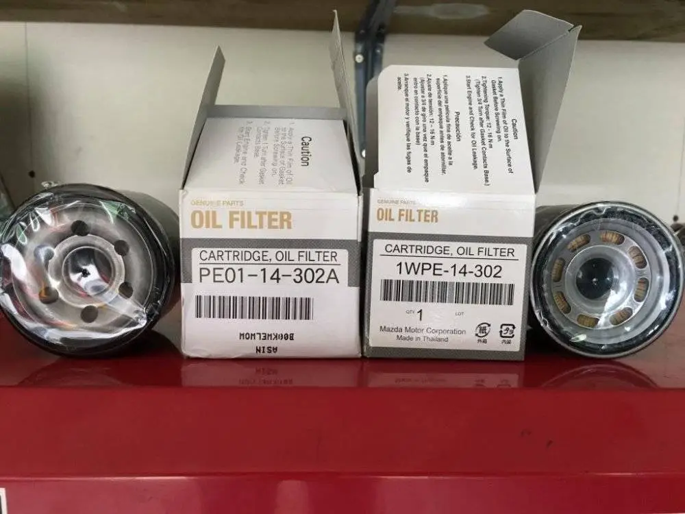

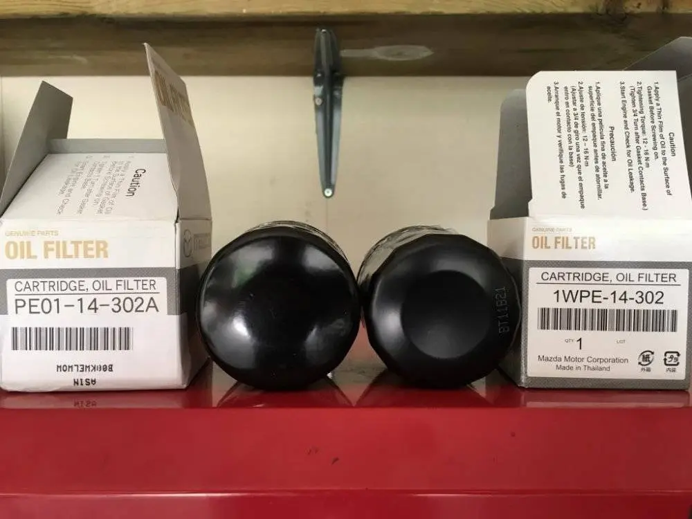

So is the conclusion that the Mazda oil filter tool should only be used with the Japanese made filter and not the Thai version?
See post #2:
“I ordered a "Genuine" Mazda Oil Filter Wrench A255 for $10.20 from Med Center Mazda along with oil change kits years ago but it ended up exactly the same as https://www.amazon.com (commissions earned)https://www.amazon.com (commissions earned) The sizes of CTA A255 cap wrench are 65 & 67 mm with 14 flutes. It fits Mazda OEM Japanese oil filter perfectly on 67 mm and OEM Thai oil filter on 65 mm size.”

Yes, Thai made OEM Denso oil filters are a bit smaller in diameter than Japanese made OEM Tokyo Roki oil filters. The stock oil filter on 2.5T is Japanese made Tokyo Roki PY8W-14-302, but Mazda North American Operations had stopped supplying PY8W-14-302 a couple of years ago and it’s superseded by Thai made Denso 1WPY-14-302 which is smaller. Usually it isn’t an issue unless you use cap wrench on the oil filter. I ordered a "Genuine" Mazda Oil Filter Wrench A255 for $10.20 from Med Center Mazda along with oil change kits years ago but it ended up exactly the same as https://www.amazon.com (commissions earned)https://www.amazon.com (commissions earned) The sizes of CTA A255 cap wrench are 65 & 67 mm with 14 flutes. It fits Mazda OEM Japanese oil filter perfectly on 67 mm and OEM Thai oil filter on 65 mm size.
Here is the size comparison between Japanese and Thai oil filters for my 2.5L. The sizes of OEM oil filters used on the 2.5T are the same as on the 2.5L.
I just did the 1st oil change on my daughter's 2021 CX5 GT today and came to the conclusion that I need a filter wrench/cap for the the next time. Searched and found your post, I will order the filter cap you posted. Thank you for your contribution.
