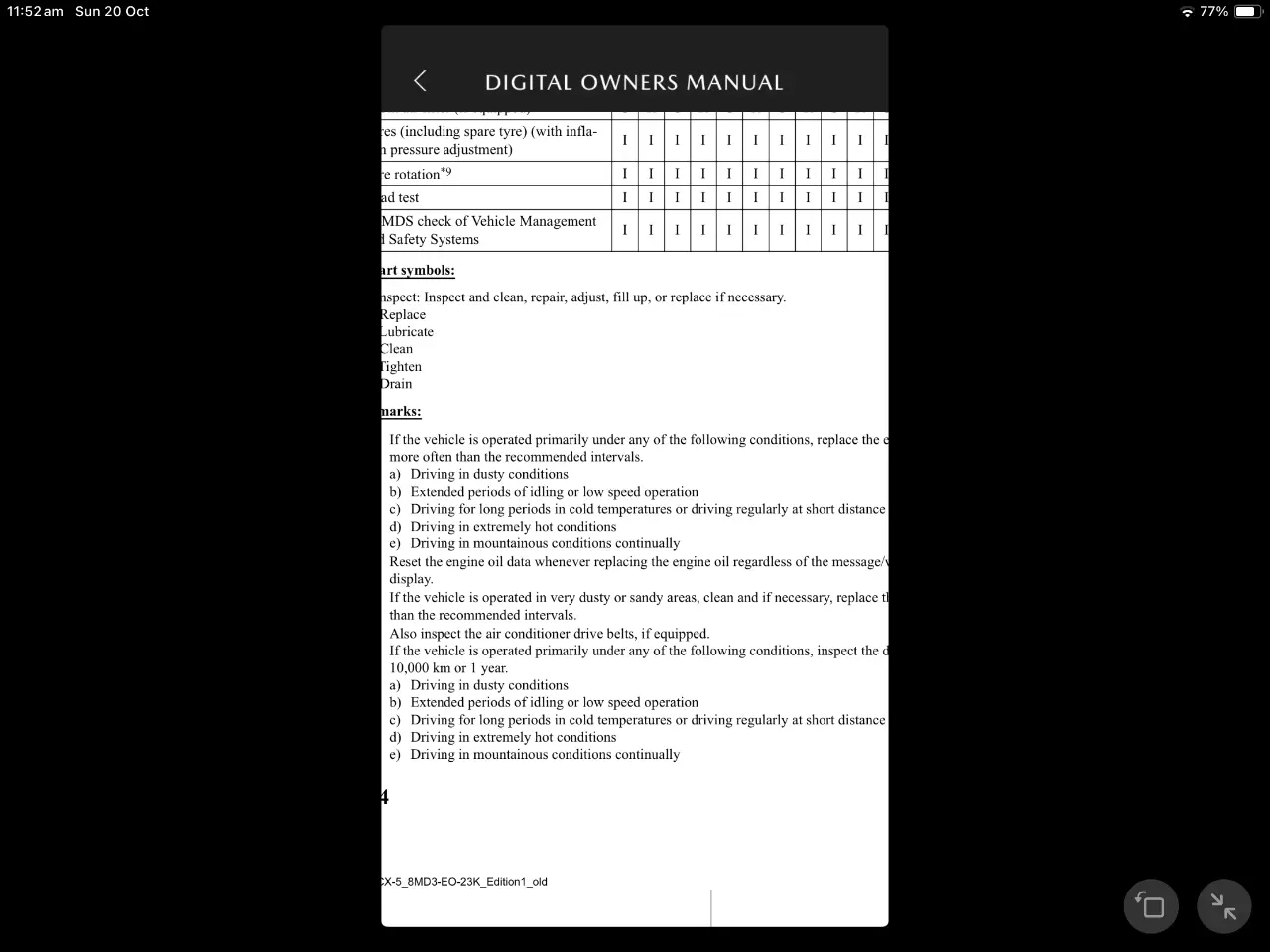

I dont think the info in the app was written by the engineers and that is where the quote in my first post came from. The “guide” in that app.
I searched the owners manual itself and for the life of me, couldn’t find the same statement in there. Ni mention whatsoever.
So its the PR team thats likely written the app info. Whether engineering had any input to that is unknown.
The manual does however include the standard statements about more frequent oil changes in certain conditions such as lots of stop/start city driving, which is what we mainly do.
They state "the first FULL SERVICE... and oil change". (Edited for clarity).

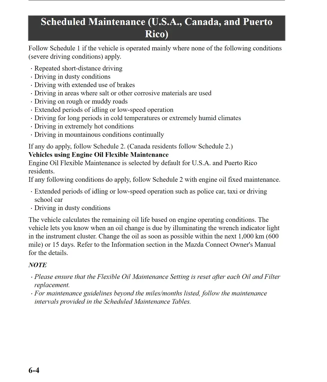

the manual actually doesn't mention normal city driving. it says regular start/stop driving like a police vehicle or a taxi
