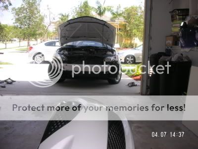

Bumper was a pain in the ass at first but we finally removed it.

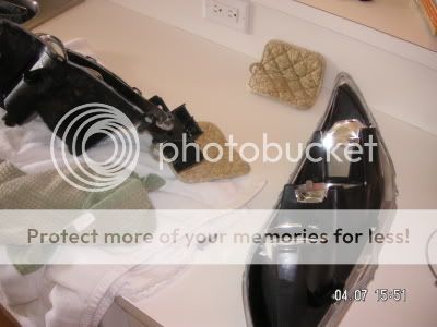

After the bumper, we removed the headlights and tried doing it with a hair drier like the instructions said, but it doesnt do s***. The oven idea was pretty good! so we tried it and it worked.

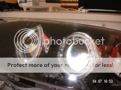

Aligning the halos wasnt too hard, but making the wires go through the back of one of the lights was a pain...very frustrating. But we finally did it with some will and brute force.
Here's the headlights already sealed:
Make sure everything is aligned and that you clean the inside BEFORE you seal it.

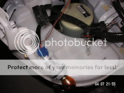

After we finally got done with the halos inside the headlights, we went and did of course, the wiring.
When we finally stopped staring at the wiring of the car thinking of how the fcuk we were going to wire that, we came up with a good idea. We went and bought some tap slices at home depot to fit the daytime running light wires with the wires of the halos...it worked.
The blue things are the tap slices (or however they are called) we bought.

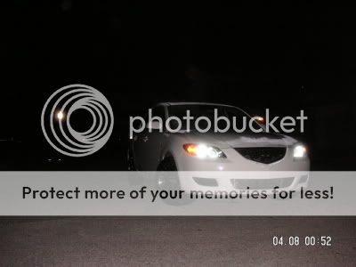

I'll take some pics when I can during sunset so you can see the lights...tried at night (because thats when we got done) and there's too much glare.

nice but i recomend getting rig of those splices. i recomend solder with a good heat shrink. those splices suck ass and tend to corrode very easy!! i work on electrical wires everyday on mil a/c and see corrosion and what it damages every day!
looks great just redo the wire taps!!
rob
yeah same advice here from another person who works with electrical components daily, solder and heatshrink... won't have to worry about it again.

unless you use heat shrink tape, you'd have to take it all apart anyway because the heat shrink used from the begining would be a tube and have gone on befor you solder your connections...i'd solder it and heat shrink...you'll never worry about it again...!

the best thing to do is remove the splices. if you are not willing to do that (too lazy, sorry but those splices suck ass and need to go) then cover the whole thing in chaff tape!! it only sticks to itself and it resists corrosion. i get mine through the military but summit sells it!!
it is expensive but if you do not want to solder i highly recommend it!!
