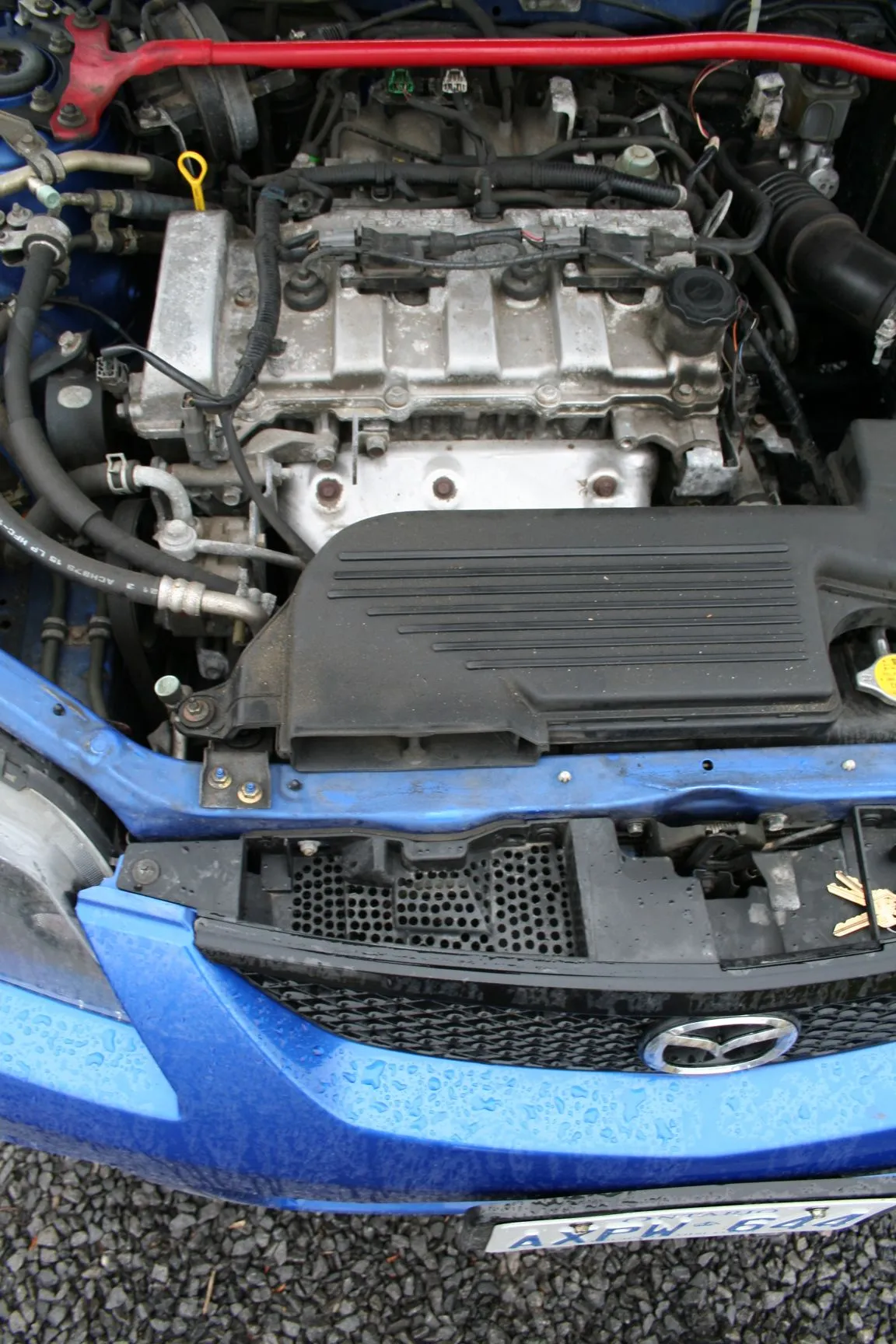

I bought a Ebay SRI and never liked it.
I had it on for a week. It gave the engine more midrange torque. But it also became alot harder(trickier) to launch the car. And IMO it sounded like crap. Yeah it was louder... but this engine just does'nt make a pretty noise IMO. And there is also the fact that the intake system hits the brake MC even with the pipe cut. Sorry guys...but I think its a crappy system.
I went back to the full stock system with the MAF screen punched out and never looked back. The car now revs alot easier, it doesnt buck when you launch it. And make just enough noise.
You can see in the picture how I have the grill cutout.
With that being said...I also breifly drove another P5 with a K&N typhoon and RB exhaust. That intake system is MUCH better than the eBay one. If I had to buy an intake again....I would go K&N. But im happy with my car just like it is now :)
