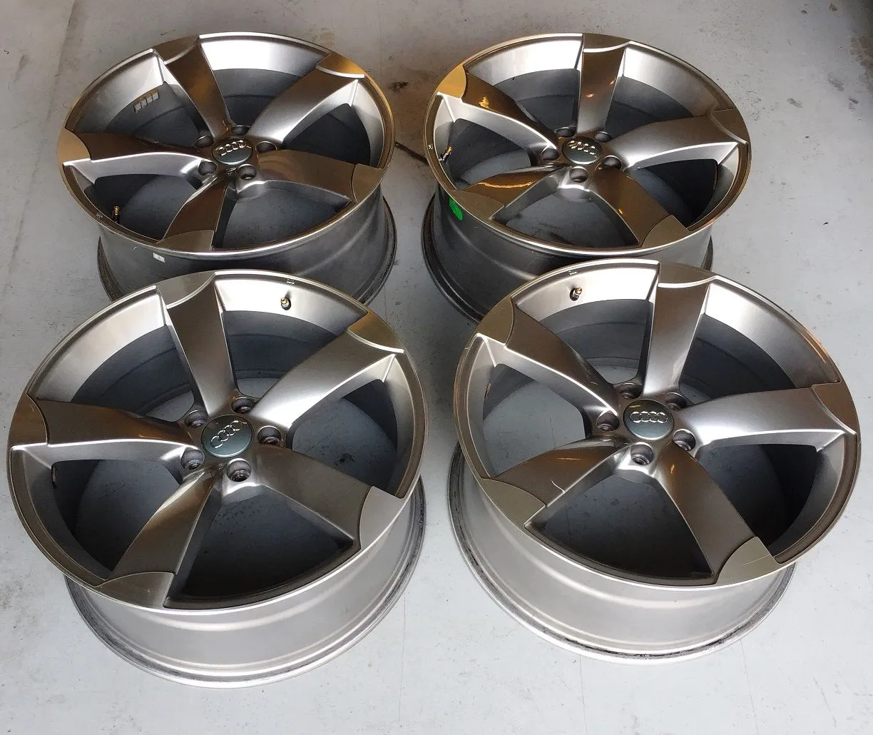

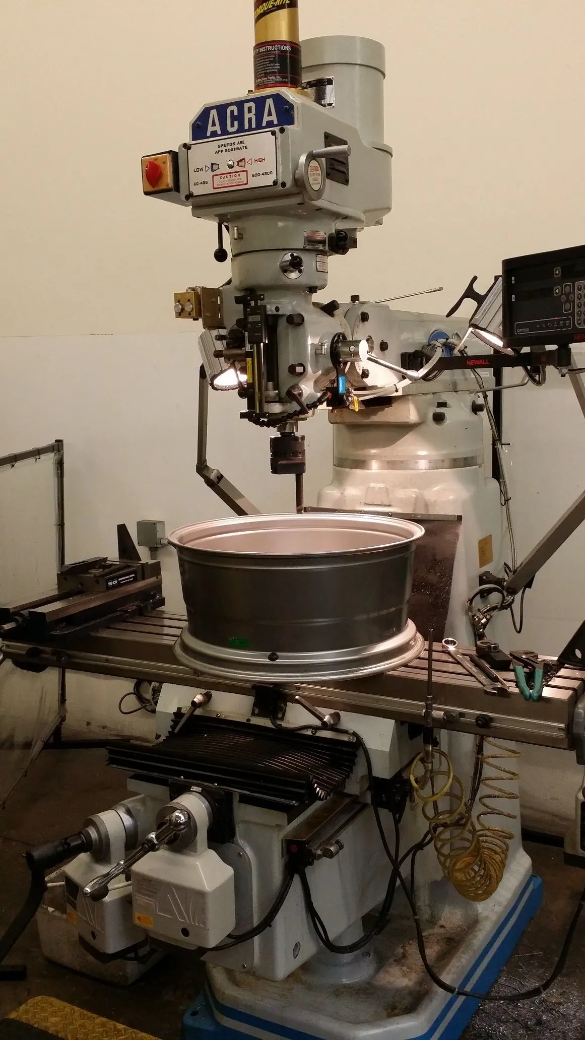

I have modified some 20" Audi RS4(Andros R9) knock offs to fit my car, but I haven't mounted them, instead I have purchased another new set of wheels.
Somebody painted them for me, and they came out as shxt.
I have even purchased wobble bolts for them. I have bored out the center hub diameter and machined off 2MM, for better ET.

What is wrong with spacers?

Always liked those andros wheels and briefly looked for some replicas in 5x114 with no success. Not sure Id ever use wobble bolts though...seem a bit sketchy
I don't see any sketchy thing about it. Think like it is a thick washer shifted a bit(~1mm). They are pretty expensive as well, they were well over $130.
