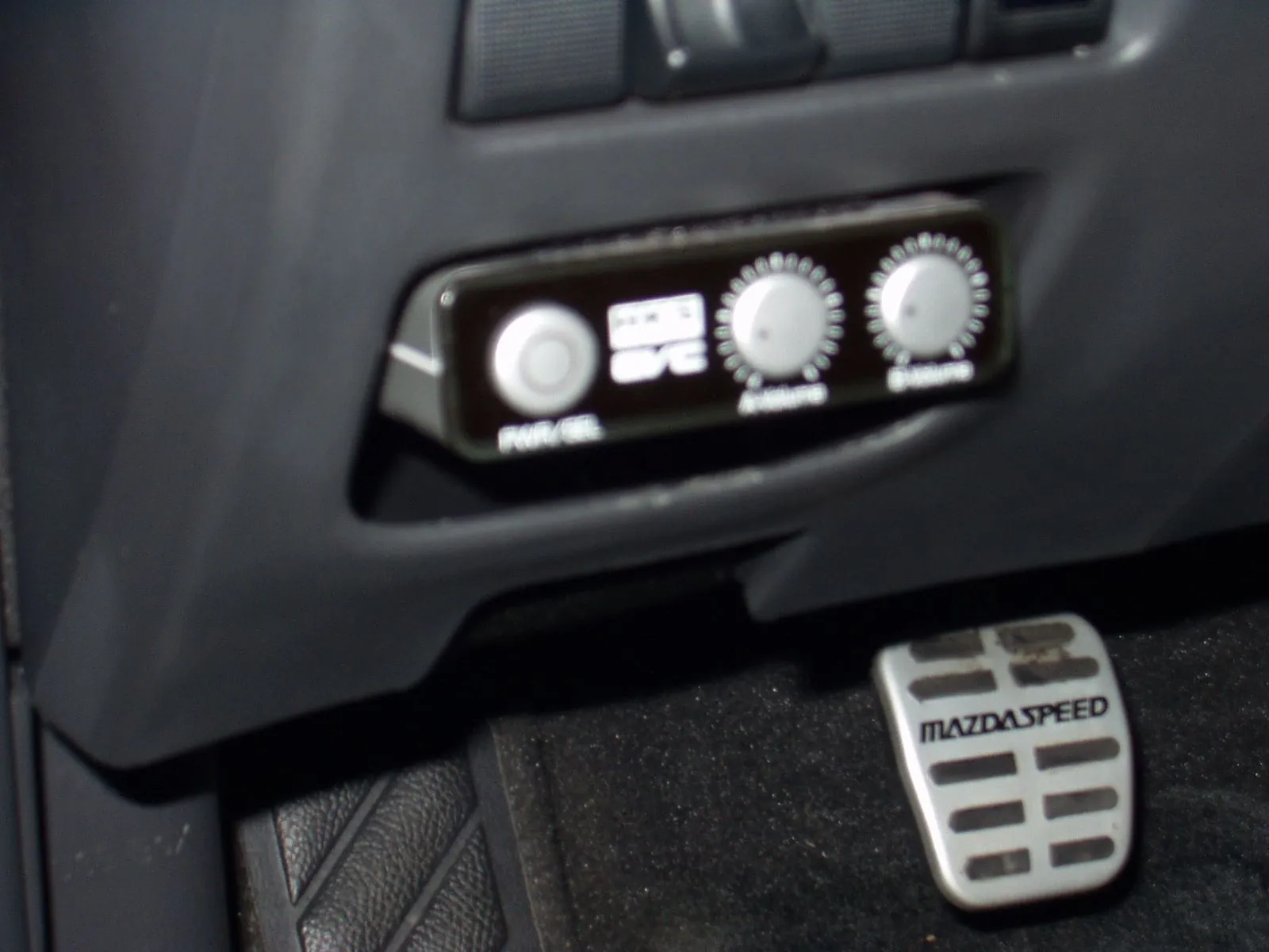

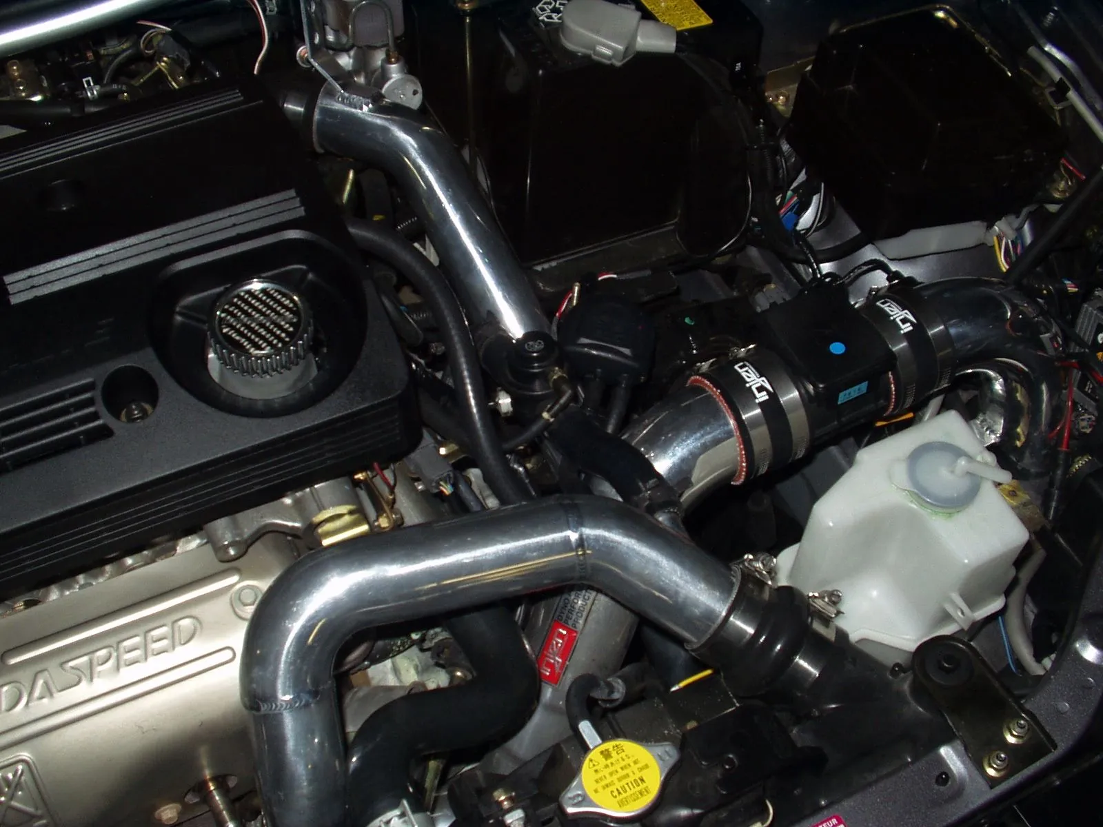

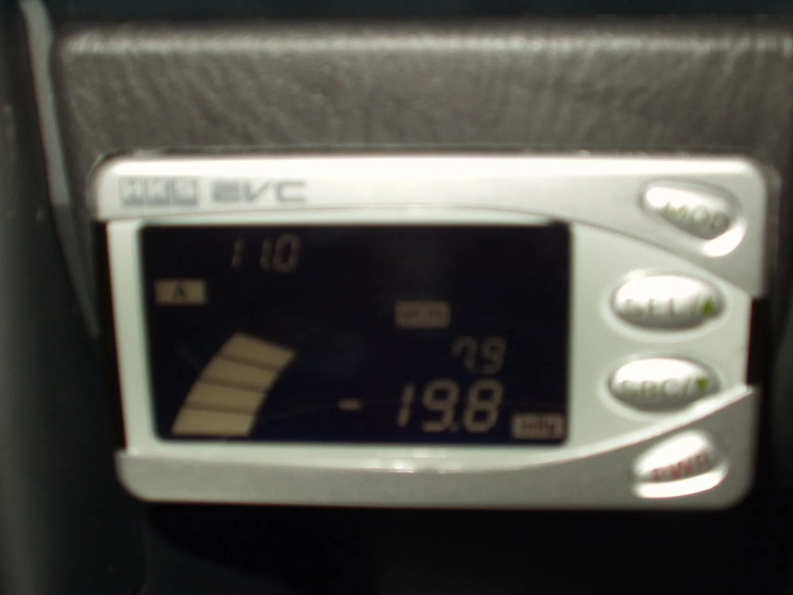

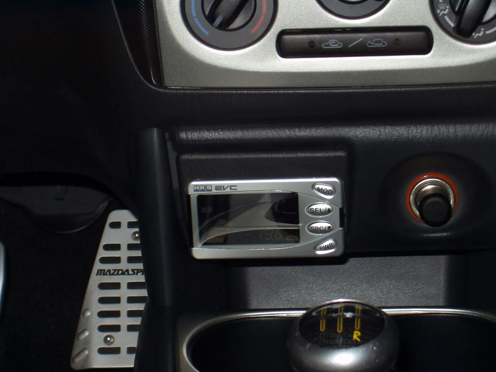

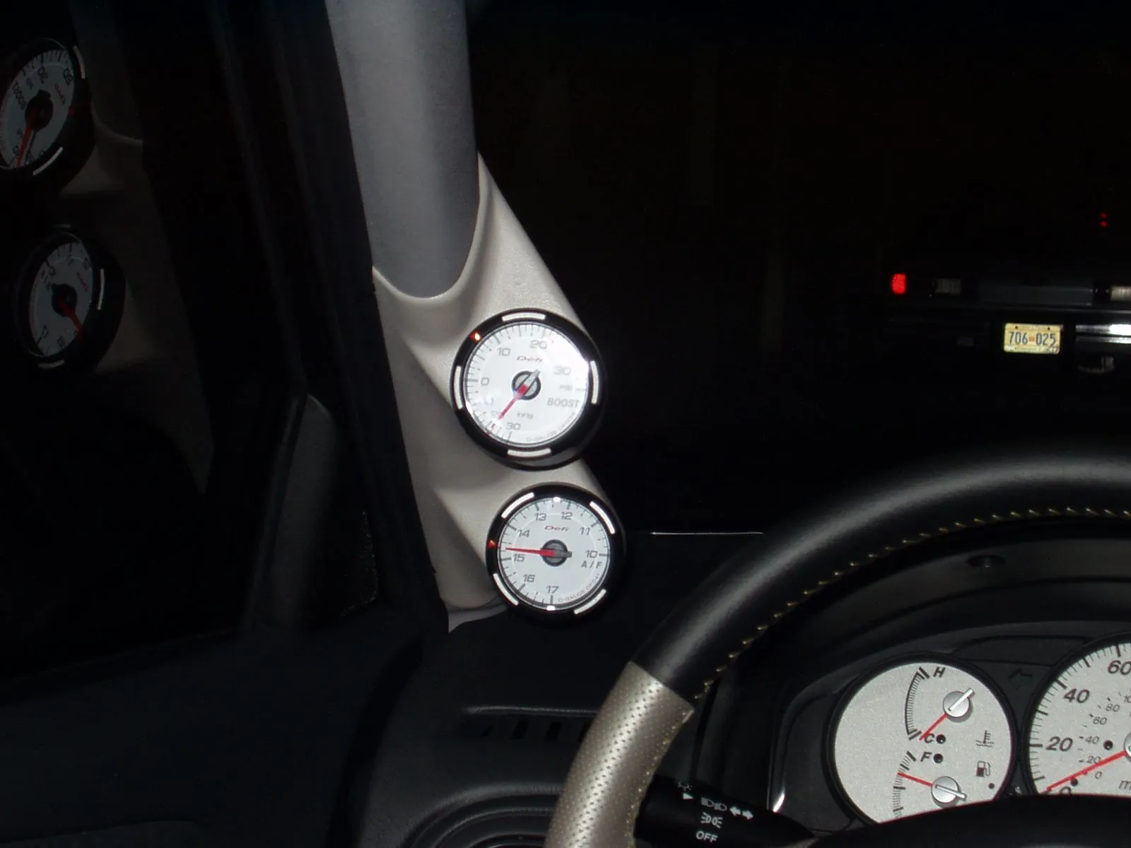

Here's a pic of my Turbo Hoses installed, and also my HKS EVC Boost Controller I just had custom installed.

how long did it take you to install them? did you have a hard time taking the stock pipes off?
It took about 45 mins to take the stock piping off then put the new Hard Pipes on. Might have gone faster, but engine was still hot. Taking the the plastic stock pipes was pretty easy with the engine warmed up, just a few twists of the wrists, while pulling took them right off. All you will need is a phillips screw drive to loosen and tighten the clamps. Also a small wrench for the one bolt on the long harp pipe assembly.
You will be better off tightening all the hose clamps with a 8mm socket vs a screw driver. You don't want any leaks and the socket/ratchet combo will let you torque down on the clamp better. Don't overtighten the clamps to the intercooler, as they are plastic.
The sensor on the bracket is held on by a 10mm nut. Its an easy job and anyone can do it.
