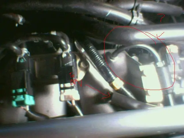

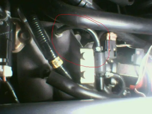

Cullen ... is the the vacuum line to tap into?

********** said:
Type S applications...

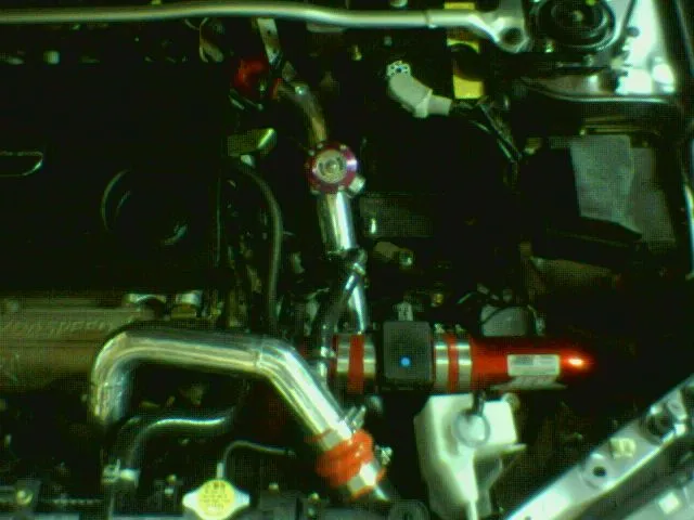

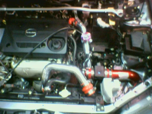

Thanks for all your help Cullen ... you have been great throughout this entire install ... i would recomend your company to 1000 people as being one of the best i have worked with. Here is my final install pic. BTW ... the BOV still isnt acting right ... seems to blow off really quickly and high pitched. The problem is that as i lower it the turkey comes back and i dont want to hear him at all. So i guess i will learn to deal with the blowoff not being quite what i was expecting. I will fool with it more tomorrow after work its getting late here. I might have missed something.
PS ... a few of those are before i attached the BOV vacuum line ... and BTW .. my camera phone sucks.
