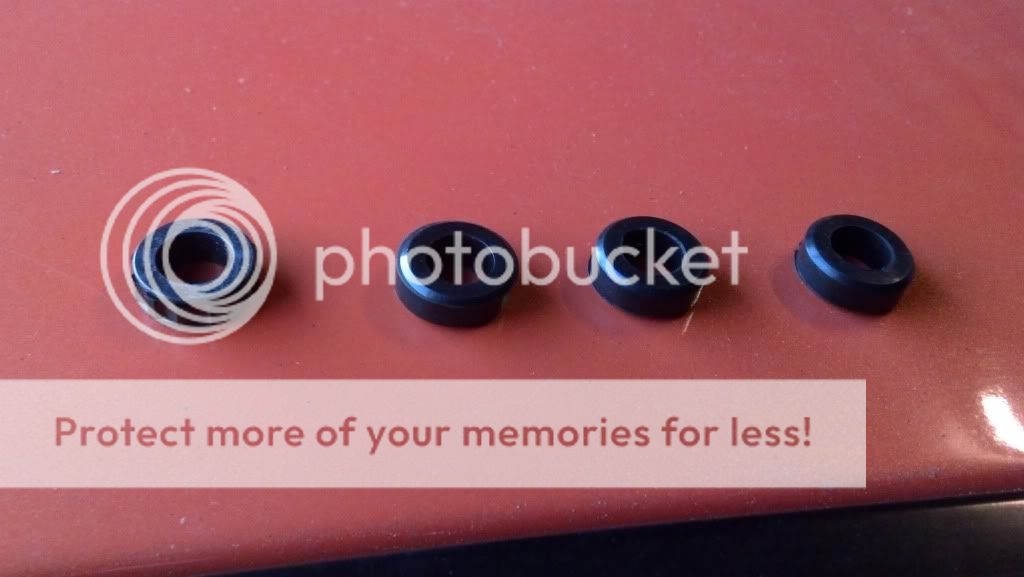

i've used both the stock rail and the perrin rail and the stock injector o rings suck no matter how you look at it.
i was holding 19-20 vac and they still where leaking when i had the stock intake mani and perrin fuel rail.
but ya the 626 ones are WAY CHEAPER and better.
not sure why the make the outside of the seal ribbed like they do, its like they want them to leak
total shipping cost for the 626 injectors from advanced was 7 or so bucks
the factory protege ones where like 20 a pop, so 80 bucks in just shipping threw advanced for them plus the cost of them.

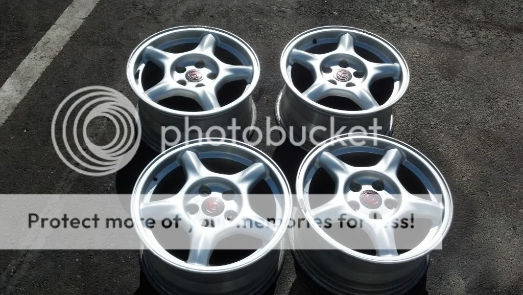

but got my FD wheels in for AutoX, going to paint them white. Been wanting to try out white wheels. Might not look bad, but with the black painted lip kit it might clash a lil.
325 shipped for them, couldn't pass them up.

but i did get the injector seals in and installed them, seem to be alright. Just finished up with it 30 min. ago.
Dam top o ring broke on the on the injector. So i start it up and fuel every where. Luckily i had like 8 packs of injector seals so i was able to fix that quick.

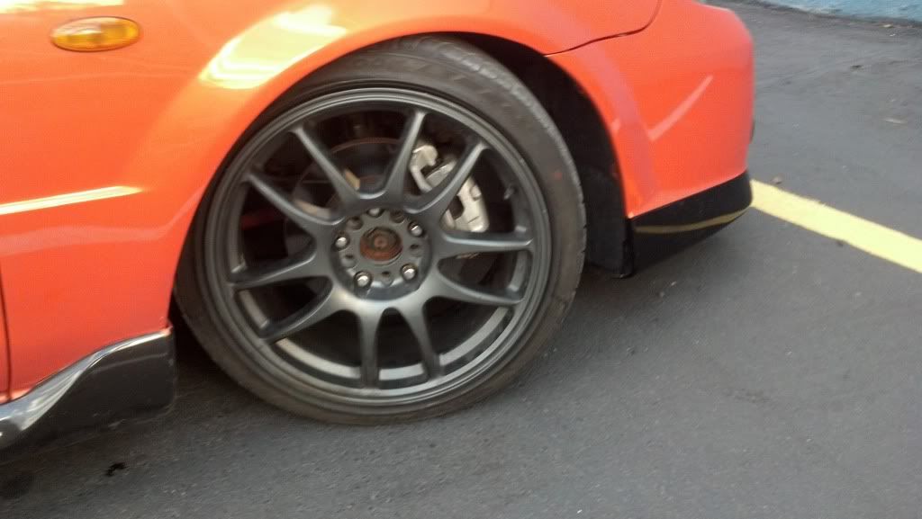

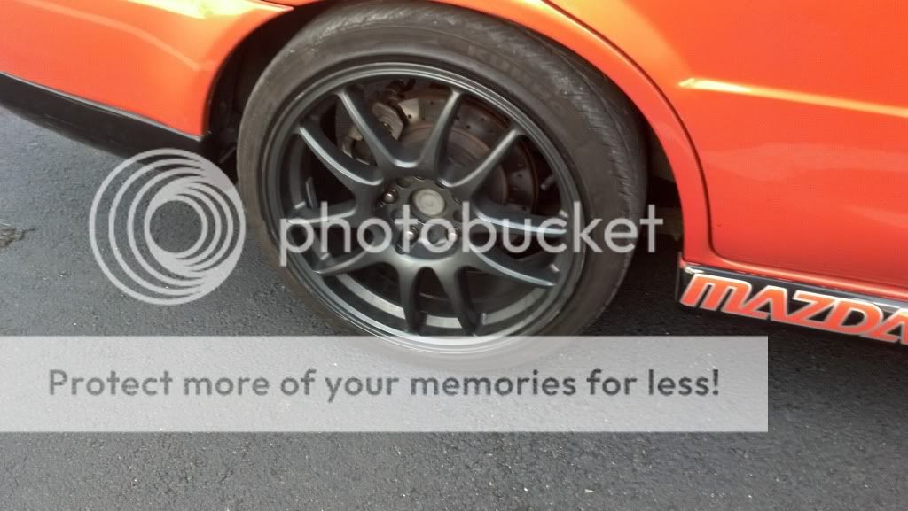

Also got my Rota Torques on today too, not too happy with them though. Have a lil poke and i had to use my bad 205 tires on them. Which make the tires stretched. 17x8 so ill be getting some Hankook V12's soon

Picture of the awesome 626 seals on the right and the bad protege one on the left

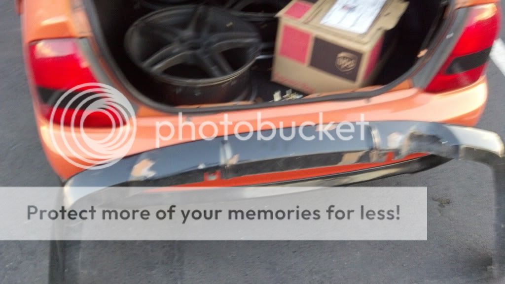

New Wheels
Old lip
New lip

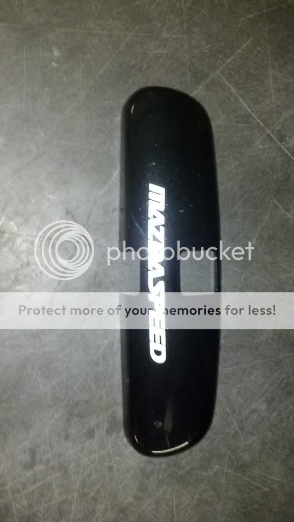

Also got a cool lil piece in too.

Need to give into the hellaflush mang....205 on an 8...lol
shut your mouth lol, every time i look at my car im just disgusted. Cant wait to get some tires for the FD wheels and get those on. Stupid stretched tires and poke

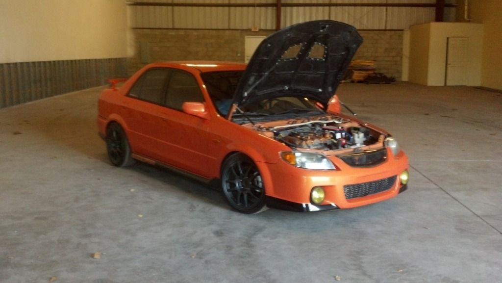

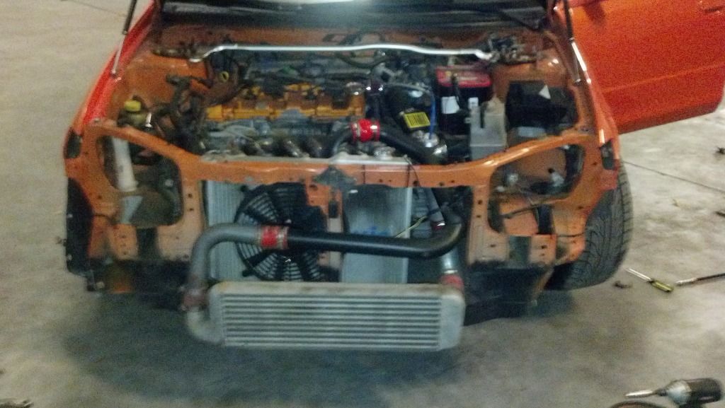

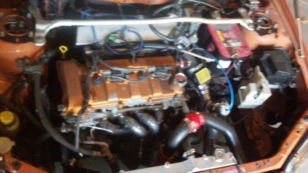

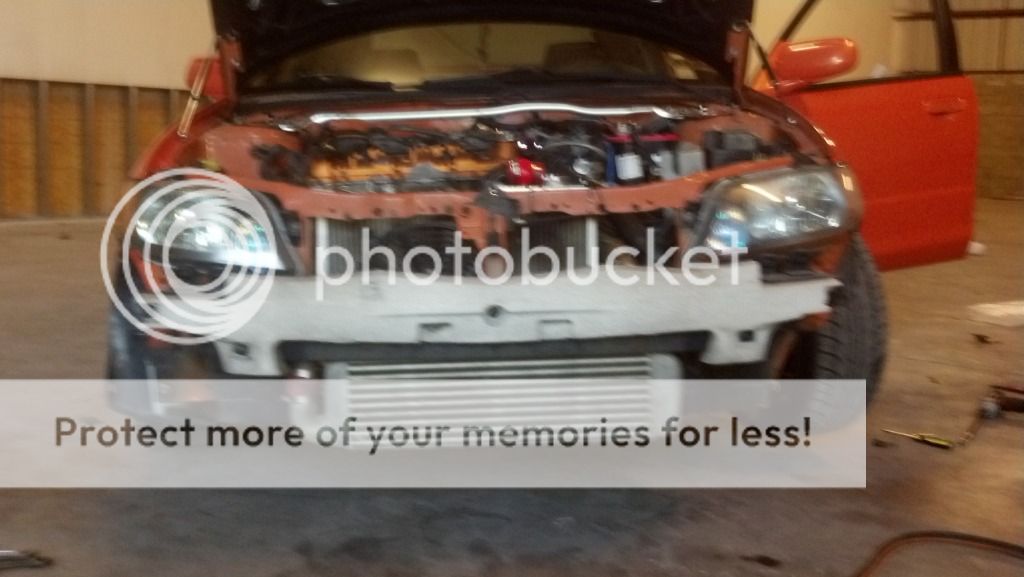

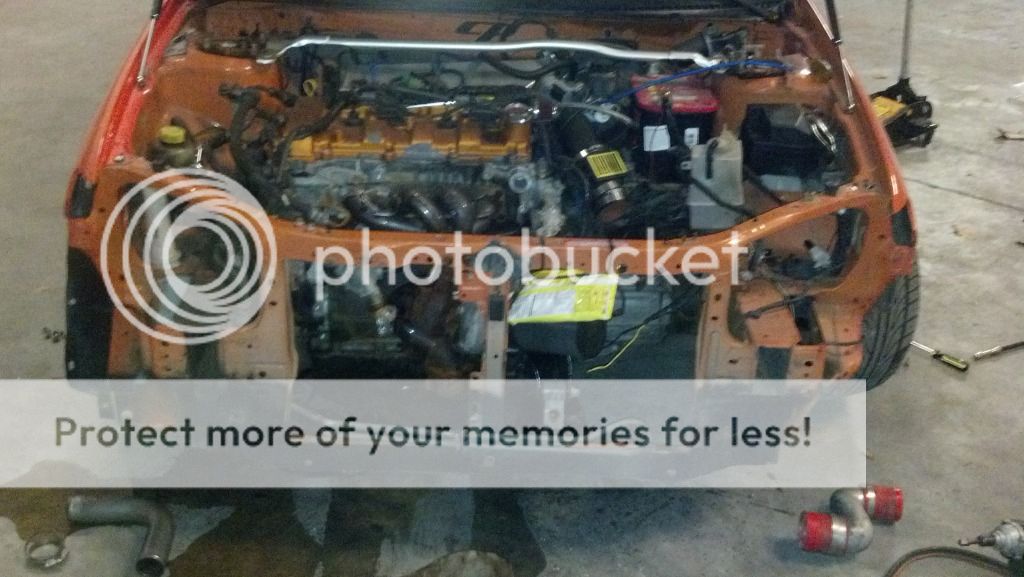

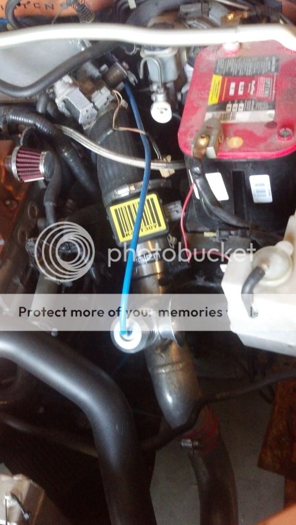

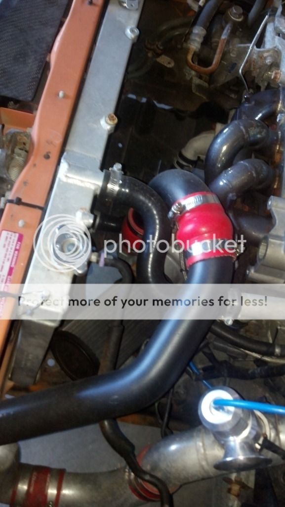

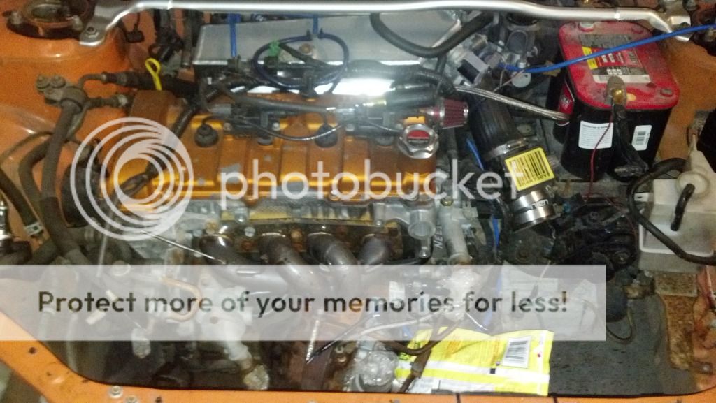

but got the car ready for the following few upgrades today.
Turbolife fmic
full size rad
aluminum solid rad hoses
Removed fogs and installing fog deletes, cutting out the honeycomb on one to make a ram intake.
bye bye fogs
bye bye hiboost
