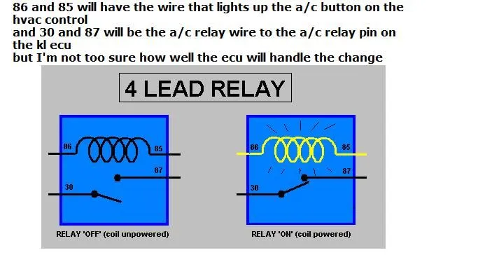

my simple explanation of the p5 a/c circuit goes if the a/c relay is ground a/c clutch gets power which cause the a/c to work
but when i hook the a/c relay wire to the kl ecu it just goes it out all the time so my clutch runs all the time, and my ecu doesnt realize that the a/c is on so my ecu dumps gas but it blows cold air and im pretty sure if i drive it and pull it out of gear it will stall out

my problem is that my a/c relay on the kl ecu stays grounded i just thought maybe if i apply voltage to the blower relay it may close the a/c relay ground

1L a/c relay (this stays grounded and once the p5 a/c relay is grounded the a/c compressor get powers on the kl compressor it runs to a pressure switch i believe and if the switch is good then the clutch gets power)
1P blower switch (p5 doesn't have a a wire and it just needs to be grounded but idk what it will do i thought it should ground the a/c relay)
1O a/c sensor
2H a/c pressure switch (these are both pressure switch so ill wire them together then wire it to p5 pin 41)
i have everything wired up to the ecu except the blower switch because the p5 doesn't have one, but when i ground it nothing happens and when i give it power nothing happens
and my a/c clutch stays on the whole time
so im not too sure
ive noticed when i switch the fan speed between 2 and 3 that the clutch kicks off for a second ill be playing with that relay to see want i can do
maybe wire in an additional relay from the "AC on" on the KL ECU? If you noticed a definite break in the clutch engagement when making a mode change - it may fix it.
this is my plan
