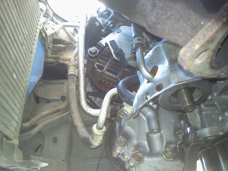

I'm driving a KL swapped P5 as we speak, and my compressor says N25 stamped on the bottom. The P5 lines look just about right - but they are just too large on the fitting side (the actual plunger with the o-ring that goes into the fitting on the AC compressor). The P5 has a larger diameter piece than the KL allows.

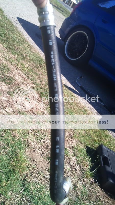

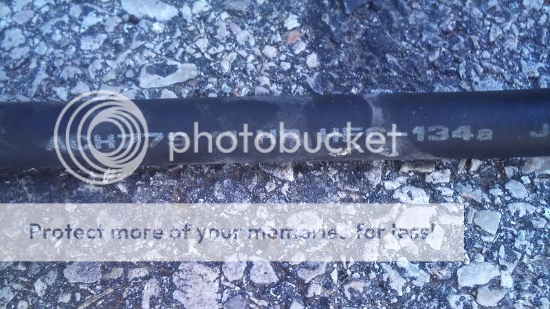

suction line (long line)
discharge line (wont fit p5)

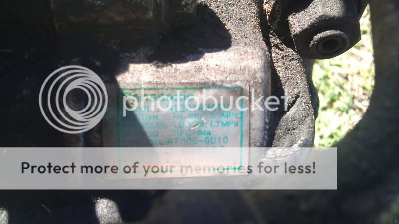

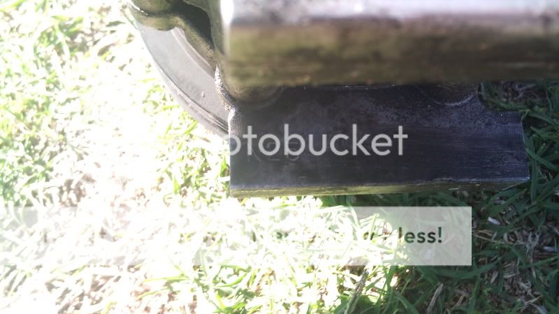

ac compressor tag
ac compressor stamp

im going to reference the part numbers off the compressor to figure out what its from
