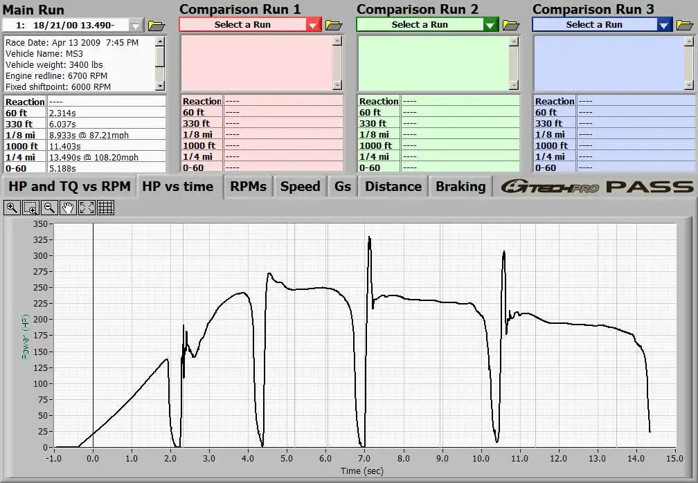

I have an '08.5 MS3 and have always felt that the car didn't have the power in the lower 3 gears that it should have. I knew that there was some torque management stuff going on, but until recently didn't know how much.
From what I could find searching the net, the estimated peak Engine (not wheel) HP in gears 1-3 is:
1st gear: ~170HP
2nd gear: ~225HP
3rd gear: ~238HP
As a result, it's not until 5,500 rpm in 4th gear that we actually see the full 263HP that's advertised. That turns out to be at 85mph.
So, Mazda is advertising a 263HP car that can not achieve that power rating legally on any public road.
If my memory is correct, there was a lawsuit in Ohio for a similar reason that resulted in lawnmowers not being rated by HP any more. The basis of the lawsuit was that the HP ratings on lawnmower engines were the "peak" power ratings of the engines, which typically occurred at 5,500~6,000 rpm. But during operation of the lawnmower, the optimal blade speed was 3,600 rpm. Therefore the manufacturers were misleading the consumers as the peak horsepower was never achieved during the intended operation of the mower. If you check the local hardware store, you'll see that almost all mowers are now advertised by their torque rating.
Anyways, where I'm going with this is that it seems all of us MS3 owners have an opportunity to either return our cars and get our money back for false advertising, or force Mazda to offer an option to remove the power limiting in the first 3 gears.
I see a lot of members have spent thousands of $$ trying to boost the performance of their cars to essentially get around something that is intentionally limiting the power in the first place. The biggest and best single performance boost the MS3 could get would be to take the shackles off of the gears 1-3.
Anyone else agree?

I noticed that too. And that crock about there being a power hold back in third gear and not getting full power until late in fourth is just flat wrong. Realize that I have some modest mods. But I'm running stock ECU tune. This attached chart shows that I develop full power (actually max power) at the very beginning of THIRD gear. While the ECU limits torque and therefore power in the lower two gears, there is absolutely no ECU hold back by the beginning of third, only 4.5 seconds into a WOT run.
BTW, brief sharp vertical spikes are electrical system artifact and should be ignored. Also note that this is real time accelerometer data collected on the open road. Aerodynamic drag is significant after you get in third gear. This pulls down the power -- you never see this effect on a chassis dyno.

Several people have questioned whether or not it was serious or not..... the answer is 50/50 yes and no.
I knew that in general more would disagree than agree, but on the other hand it still pisses me off that a car manufacturer doesn't have to provide full disclosure.
As I said when I bought the car, I knew there was some power limiting in 1st and 2nd gears, but honestly, I thought it would still deliver over 200 hp in each gear.
A buddy at work has a an '07 Golf GTI with a 6-speed Manual, and I gotta say that up to 60 it feels like it pulls just as hard as my Speed3. I thought the MS3 should have been able to leave his ass in the dust.
Again, the point is that Mazda sold a lot of these cars by prominently advertising the 63HP advantage it had over the Civic SI and GTI. In most real world driving, the power advantage just isn't there.
How could you not agree that it should have been documented somewhere in the Mazda literature exactly what we were buying?
What if you bought a High Def TV and found that it ran in normal resolution from 8:00AM to Noon every day, because the manufacturer decided you just don't need that much High Def?
