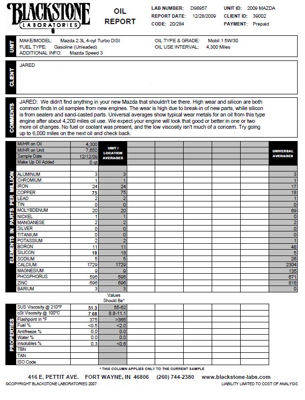

High wear and silicon are common finds in new engines, such as yours. The excess wear
metals are due to new parts breaking-in, while silicon is from sand-casted parts used when
assembling your engine.
Thats straight out of my used oil analysis on the factory fill.
Oh, and just as a little sidenote, Mass Spec doesnt identify any compound, in anything. It merely assigns an amu to whatever flows through the source and gets ionized/fragmented. As Blackstone uses ICP-AES to do their spectral testing, they only have emissions to determine elements, and not the wonder of MS. Furthermore, silicon exists as about 20 different isotopes in varying concentrations, with the most common being 28Si. If this were actual silicon coming from a fitting wearing (which it isnt), the amount of insolubles and polymers would be through the roof.

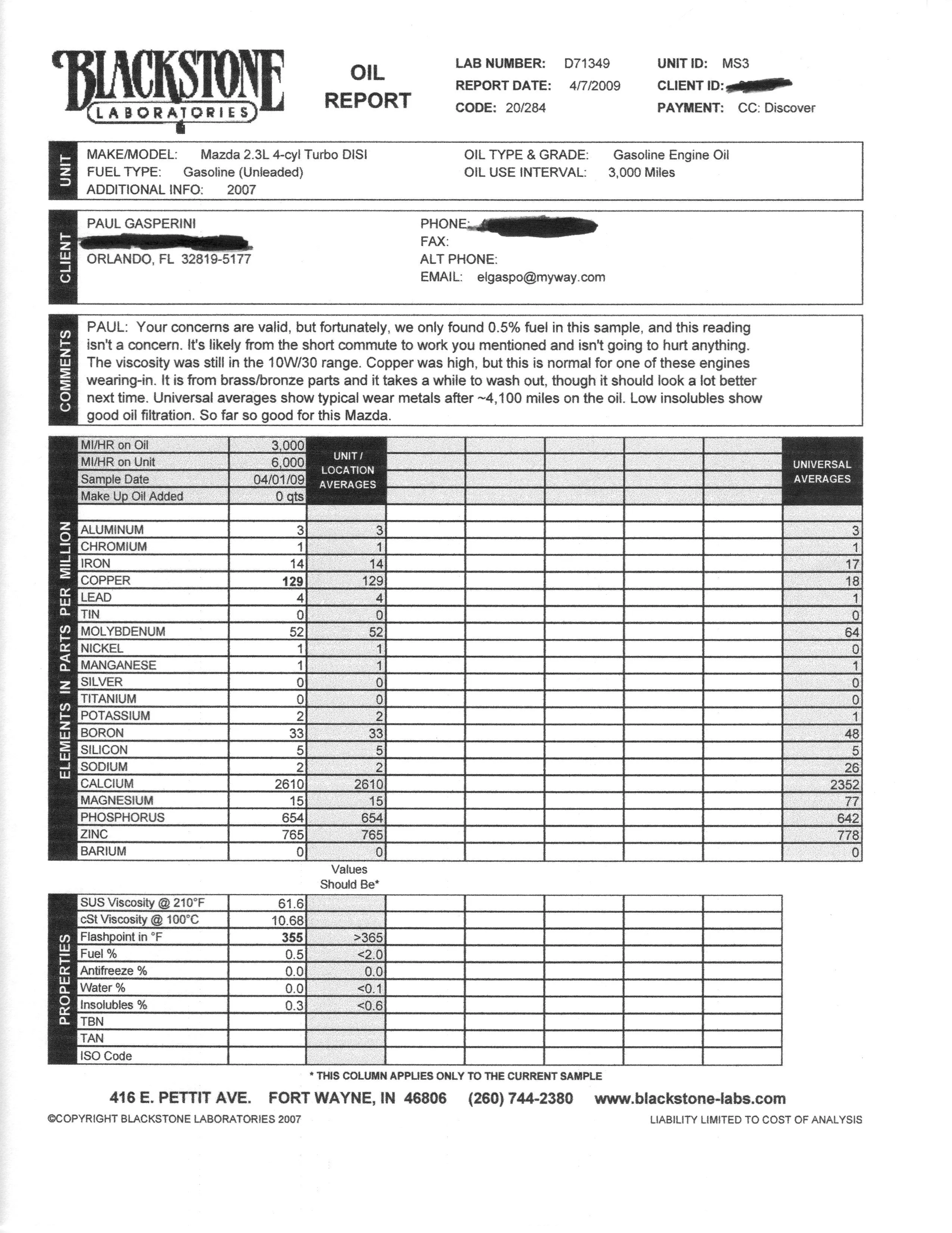

Just got my 2nd UOA back after 5000+mi on Castrol Syntec Blend 5w-30. Looks good except for high Sodium which seem to have come from oil additives. I had CAI during the interval and Silicone dropped, so i don't think intakes contribute to Silicone levels.

Here's my lab for Mobil 1 5w30 @ 4300 miles. I switched over to PP 5w30, I'll get a report on that after ~7,000k miles. The car had 7,000 miles on it when this sample was taken.

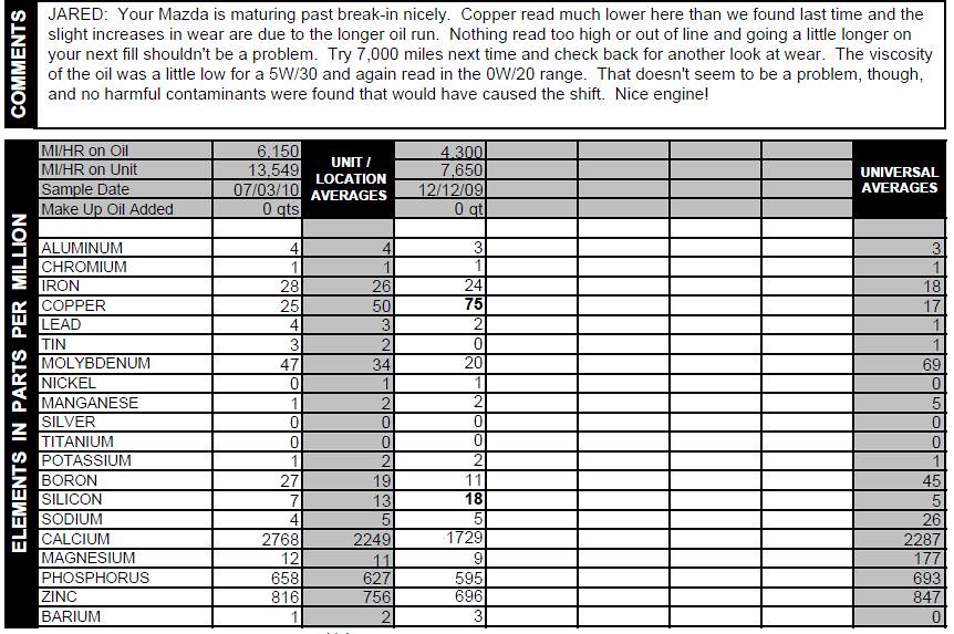

I've got 54k on the odo, I haven't sent a sample in since 15k or so. I'll send this next one in so we can see what higher mileage looks like.
Here's the latest with about 7000mi on the oil, used Pennzoil Platinum 5w-30 with OEM filter. Overall, happy with results, will continue with PP. Only engine mod is CAI at 1200mi. Report says 9000mi interval should be fine.(headbang)
