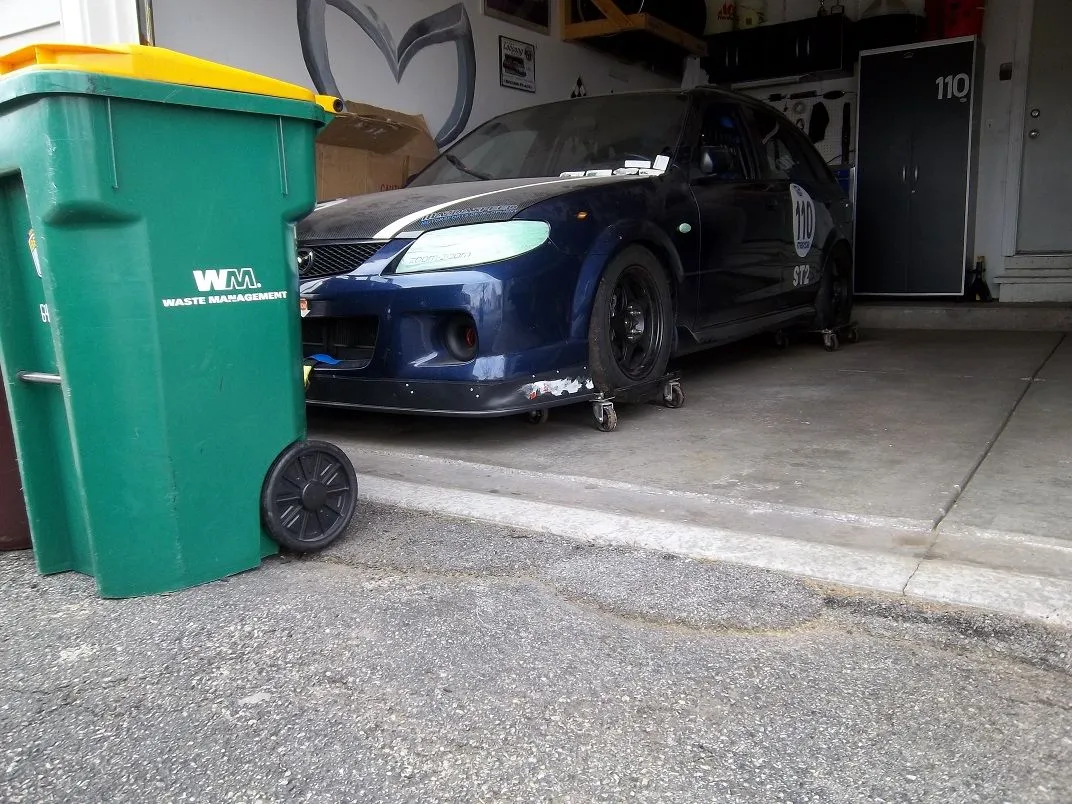

Here is a pic of the Camaro wheel studs installed with a roto slipstream wheel and stock OEM brembo rotor and no spacer. Got them from Pegasus Racing for the same price as summit.

Not sure on the year. Its listed as "late model camaro/vette". They are quick to come up at Summit and Pegasus and there 38 shipped. So no too bad. And the lip is a garden divider from a menards home improvement store.
thanks for posting the pics. i've been looking at getting these studs and have been trying to get an idea of how much they stick out.
