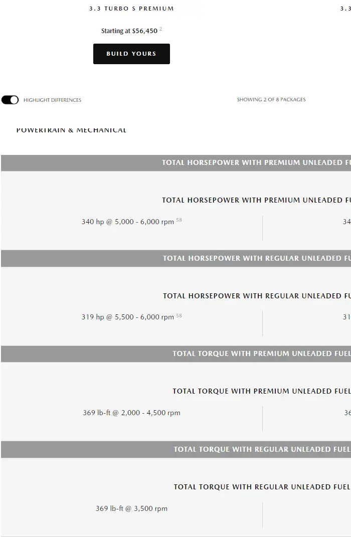

Has anyone been regularly running one of the Turbo S engines (nominal 340 HP) on US-standard regular unleaded (87 octane)?
I know there'll be a drop to 319 HP on the lower octane, and max torque caps at 3500 rpm vs. 4500 on premium, but have you experienced knocking or other things?
Given that Mazdausa does list the HP/torque for both premium and regular unleaded, it sounds like it should operate okay with it.View attachment 326102
