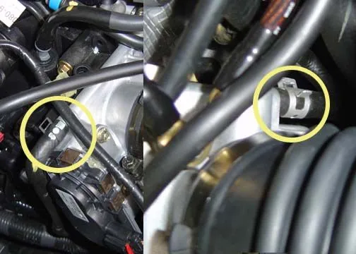

are those the coolant lines??
i went to the Mazda6 link and wasnt able to look at the photos
and btw the TB gets hot preatty fast.. i only ran the car for like 6 mins ant the thing was way hot...

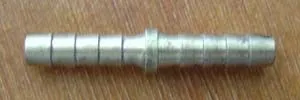

What if we made the mod with the male/male connector and utilized the it only during the summer months? Do you think the connector could be placed/removed w/ minimal trouble? I will be honest the thought of my TB freezing on the way to work scares the s*** out of me.

omw to pick up a male to male 3/8 conector hehe... the sad part is that im going in my 3 soo gotta wait a long time before i install it...
Got the conector.. now waiting for the car to cool down :mad:
You might want to get some rubber caps to put over the pipes on the ETB. You don't want any crap getting in there while it's disconnected.
