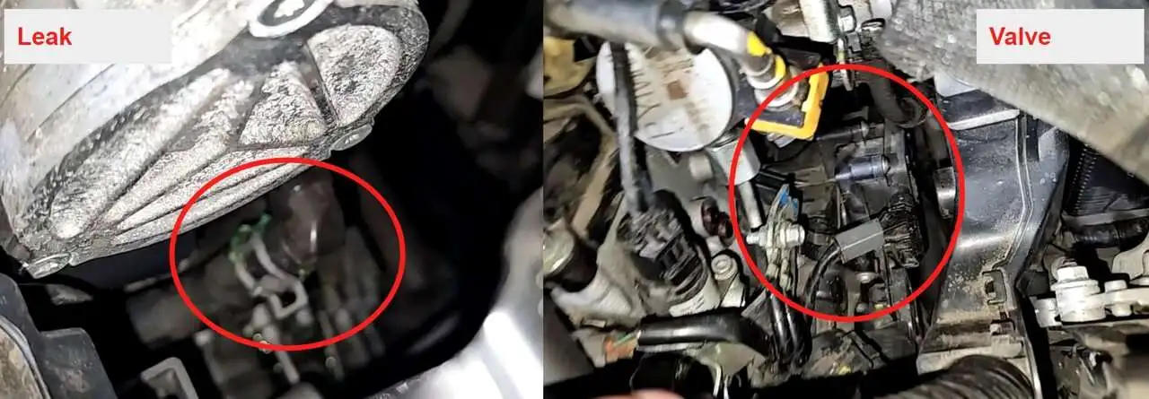

The shop showed me an image of coolant leaking from a small-ish hose clamp. When the engine overheated, there was a lot of coolant splattered all over the engine compartment, I suspect the pressure caused the reservoir to overflow and splatter. It seems reasonable to me that some hoses would leak a bit in that condition, but should be fine otherwise, I would think. The shop wants to replace the "coolant control valve" (if this could refer to multiple components, I don't know which one they mean by its full name, but it is pictured) and do a coolant flush.
Is there any reason to think that the control valve actually needs to be replaced? The engine was only overheating for a brief time, I pulled over immediately and got a tow truck.

I would rteplace the valve. Now is the right time since coolant is changed too. there is tsb for it also. See if you can go through warranty.

@cz5gt Is 01-011/21 the TSB you are referring to? I haven't had those problems with my car. The dealer shop has not explained to me why the valve needs to be replaced other than "leaking", but they pointed at a hose with the leak, not the valve. My car is just over 90k miles, very much out of the factory warranty, so getting a replacement by just citing this TSB might be difficult. Unless there's a different TSB you were thinking of?

The newer valves are revised.
the whole valve concept is stupid and its because of the cylinder deactivation feature. On mine it lags to open so sometimes the car goes to higher temp before it fully opens.
If you are out of warranty (assuming valve is working as expected) then it may not be worth it as you have to pay for everything. Its costly from what I recall.

The coolant control valve TSB is actually related to the mechanical failsafe thermostat opening prematurely, resulting in the engine not heating up quickly enough, which has nothing to do with your situation.

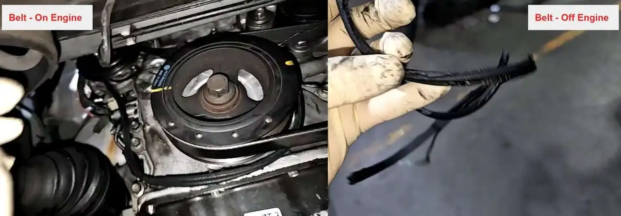

When I posted on Friday, I didn't explain what happened when the belt snapped. It was completely without warning. I was on the highway, and suddenly the dashboard lit up with warnings. The red thermometer light went on solid, not flashing. An additional engine overheating message appeared on the dash, and the ECU cut the engine power to limp mode. I was able to pull over immediately, and I switched the display to show the thermometer indicator which was constantly jumping around between just-below-red-zone and max-of-red-zone. At that point I got a tow truck. I never heard any sounds coming from the engine, even when the tow driver started my engine to get onto his flatbed.
In the image you can see both belts on the engine, with the water pump belt just hanging out. And next to it, you can see how the water pump belt was fairly shredded.
