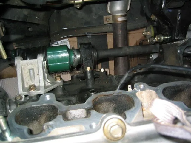

I don't really have enough leverage to pry the green piece out and I've tried using a stick and a hammer but nothing happens much. Am I suppose to get that piece out or that other bar right before the engine block? Here's a pic:

TheMAN said:
did you unbolt the intermediate shaft from the engine block?
Grab a hammer and an extension u dont care about preferably around 12 inches long. put the extension on the green part of the axle (i found using the female end was easier to keep in place) then hit the extension on the male end, it should loosen it up. Be careful not to let it drop and ruin the splines on it!!
Hopefully this helps
I had the immediate shaft unbolted at first but then bolted it back on to the block to try to get the green part off. Am I suppose to get the intermediate shaft off instead of the driveshaft?
I pulled it after i pulled the axle.
