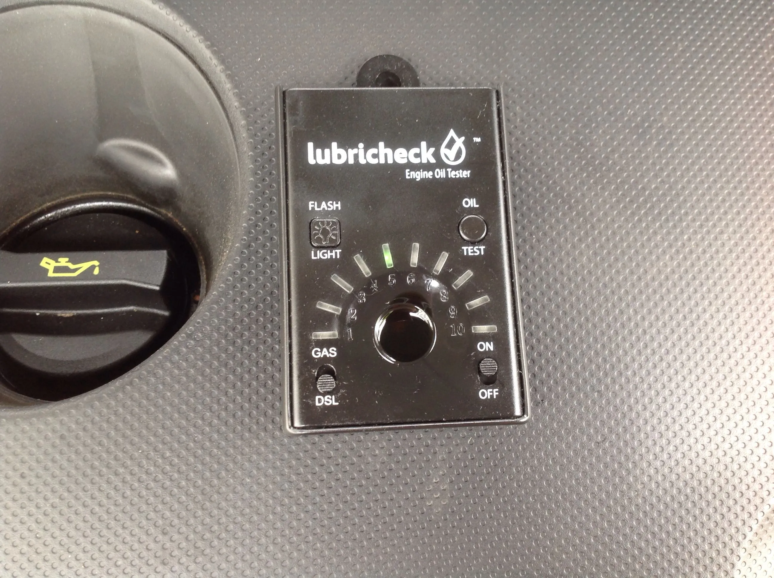

Lubricheck oil rise
Hi the dreaded curse of the oil rise I purchased a lubricheck and stopped useing the mazda oil replaced this service with mobile 1 ESP so far I have covered 825 miles from oil change with no oil rise.
The lubricheck indicates oil quality I have tested this at work and is a good indicator to oil quality worth the money and peace of mind

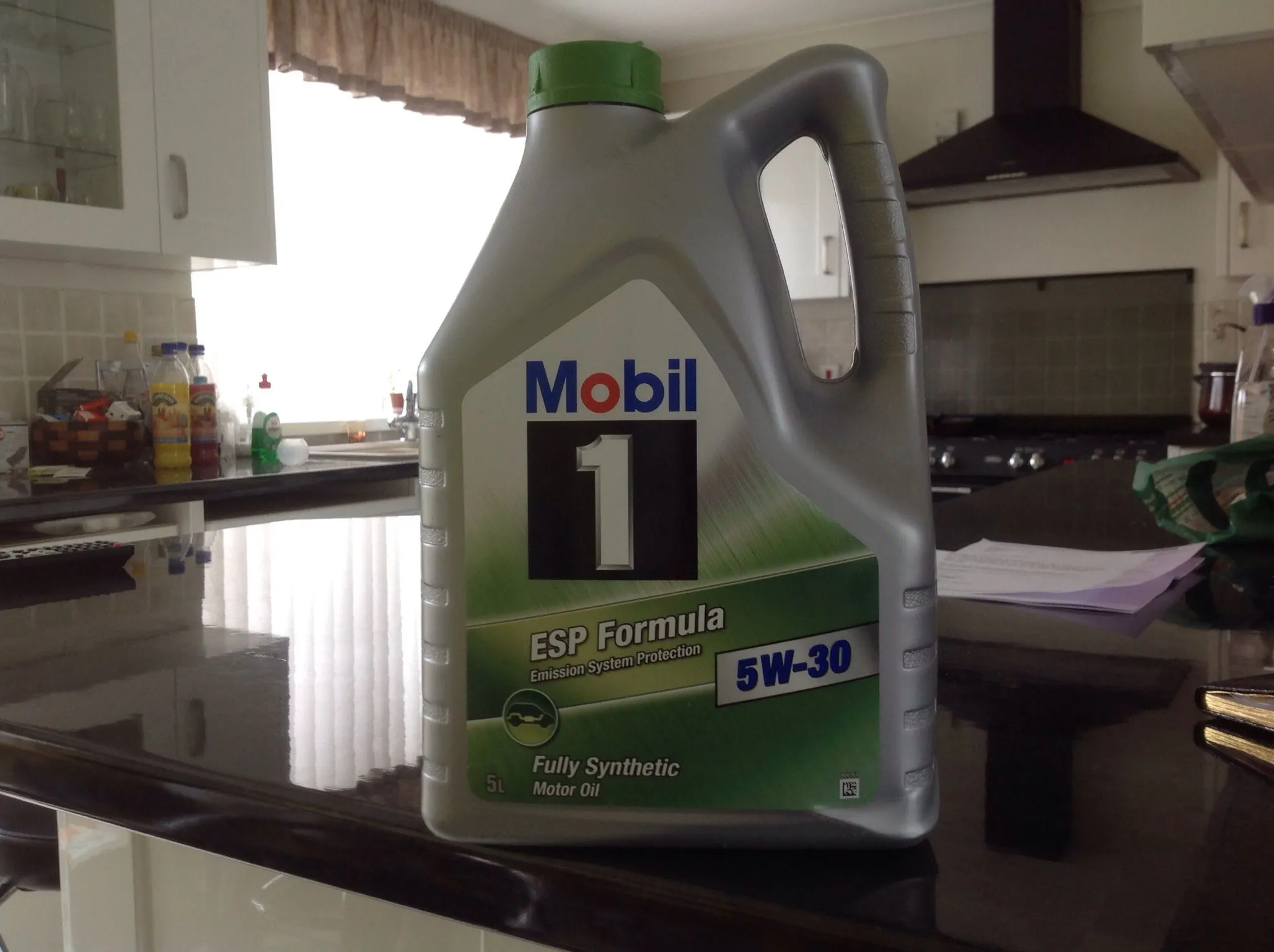

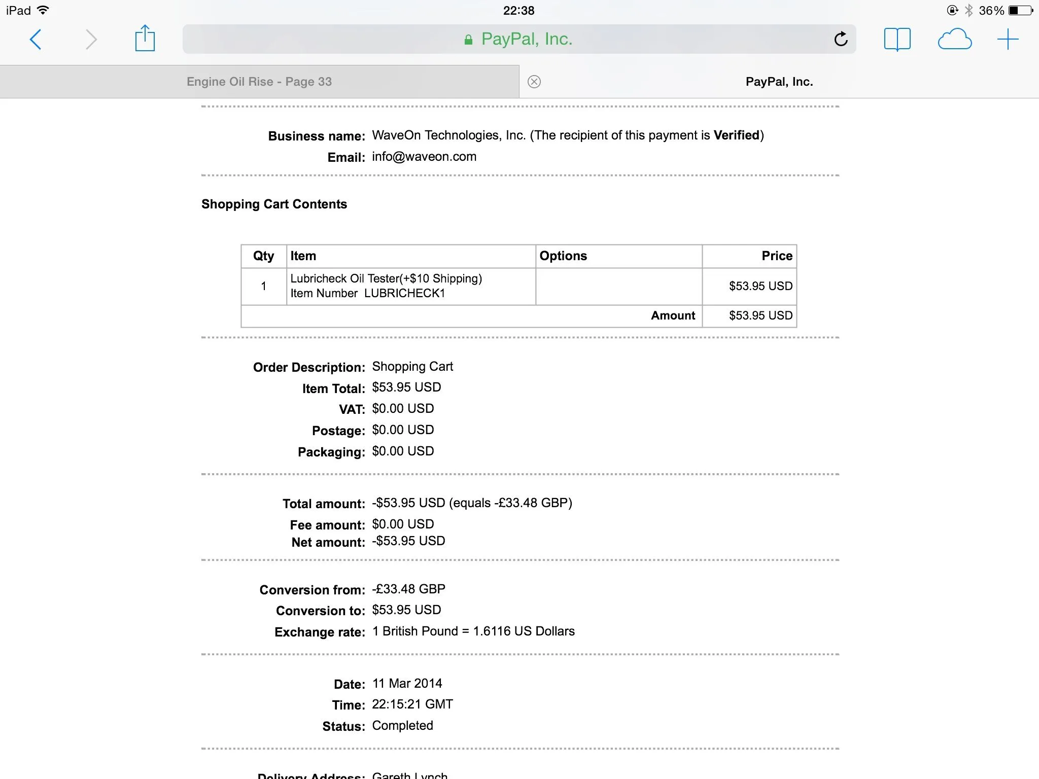

Do you have a link for where you bought the Lubricheck? and the cost.
Also what difference will using esp do to prevent the oil rise?
The following picture with cost and company name I purchased lubricheck from .
When using this device it's important to follow the instructions don't turn it on with out oil in sensor pad.As for the oil I have used this oil previously with good results it exceeds ac3 with low ash content designed for diesel DPF and costs less than Mazda oil.On the original mazda oil I was getting oil rise in the first 3 weeks.
Check out the reviews on mobil1 ESP

On my Mazda oil I've only recently had the oil rise, so I don't think the oil has any bearing on the oil rise, after all its diesel that's getting into the sump, so I don't see how a different oil will affect that.
