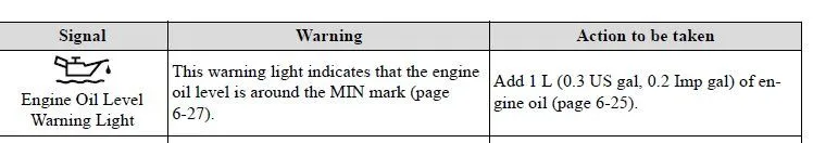

I think there are two oil indicators, one for oil level and one for oil pressure. Even if the level is a bit low you still have oil pressure. If the oil pressure light comes on shut it down immediately and tow it or you can destroy the engine without oil pressure.
It's probably at a borderline level. One qt/L will get it to the top marker
I just checked the manual , that is exactly what is advised.

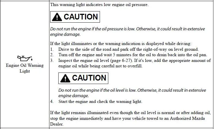

If the oil is below the bottom dot or not in the dipstick, the engine oil warning light should appear right after starting the car?
You are correct. I checked the manual, I was looking at the wrong engine oil warning light the whole time. lol
I was looking at the Low Oil Pressure icon. The icon that showed up was for Low level, the one with the wavy line at the bottom. Thank you for pointing that out.
I guess low oil pressure is more serious than low level.
