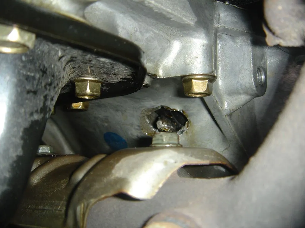

Boosting between 8-9psi, high RPM, ignition timing was off. :( Guess when they say it's difficult to hear pinging after 4000rpm they aren't kidding.

Ouch thats an expensive little hole you got there. Good thing you already had big plans for the car and the money to do it. Good luck!

be more specific ... u were running 8-9 psi for how long.. any supporting mods ?
He was running 9psi on my stock boost maps. The maps were modified, but from what I was told, the spark was not delayed enough for 9-10psi and there might not have been enough fuel added. His mods are very similar to my current setup.
how much different were the maps compared to the stock ones? Ive been pushing 8-9 and just curious if my engine will go. Does each MSP have different maps to a certain degree?

Yea what else exactly did he have in his car? No way it just blew running 8-9 psi with nothing else. Were you racing? Gunning it up a hill?
Here are 505zoom's relevant mods. Are these what you have done to your car?

Also, do you have an pics of the spark plugs and piston tops (all the cylinders)?
What was the wideband saying?

BTW...I think you win the SMALLEST HOLE MADE in a BLOWN ENGINE award! The whole is so "cute".
Ha! I thought the same thing. That is the cleanest blown engine I have ever seen. The rod punched a perfect hole.
