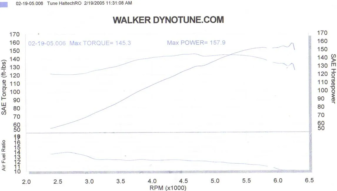

65, like Zath said, Matty's initial dyno run was with the Haltech fuel computer and for some reason the fuel maps were locked during his runs so he could not adjust them. IIRC, he dynoed a peak of 158 whp at 6500 rpm, with a fairly straight line leading all the way up to it. The torque curve was even more beautiful than the hp. It popped up to about 145 wtq at 3500-4000 rpms and stayed right there for the rest of the graph. There was one big drop in both curves right where the AF started going down fast and the injectors freaked out and started running 110% duty cycle. This is all from memory of a couple months ago, so I'll try to go back and fine the graphs.
In my car we are running a stock ecu (for now) with a BEGi FMU and voltage clamp, so we're hoping to see at least 180, possibly more, with proper fuel control. I'll be sure to let you know in a couple weeks (wink)
EDIT: Found the graph. I was a little off, but it's still pretty :)
