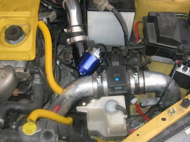

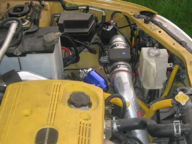

Here's my setup...I hope it helps
You either have to run a dual bov/bpv setup or relocate the maf. The maf is reading the air coming through the intake and pulling fuel to compensate the air. Then before the air enters the throttle body the bov is releasing it. Now the car has all that fuel pulled by no air to mix with it so it is causing the engine to flood or run too rich which is causing the car to stall.

Yes, that is a common problem with most turbo cars. My advise on a bov is dont run one. They make really good bpv's now and it is more efficient anyway.

They make forged bpv. The hot air is not the issue it is the lack of smooth flowing air across the sensor. I dont understand why anyone would want to run a BOV except for the cool sound it makes.

About the setup, I just recently installed a BOV on the car. Well I had a Forge BOv and simply replaced it by the one I have now. But my Idling problem started before I even touched anything on the car. Can a boost leak cause my bad idling ? If so, how do I determine it ? This Idling problem makes me want to quit on my MSP...nah thats crazy talk lollll
