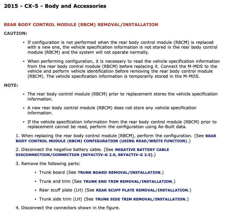

That's so weird. With all the car jacking going on, it's unsafe for my daughter, which is single mom driving with an unlock door. I have one more trick to try before taking it to the dealership for deeper dive. I will buy an used rear BCM and give that a try.

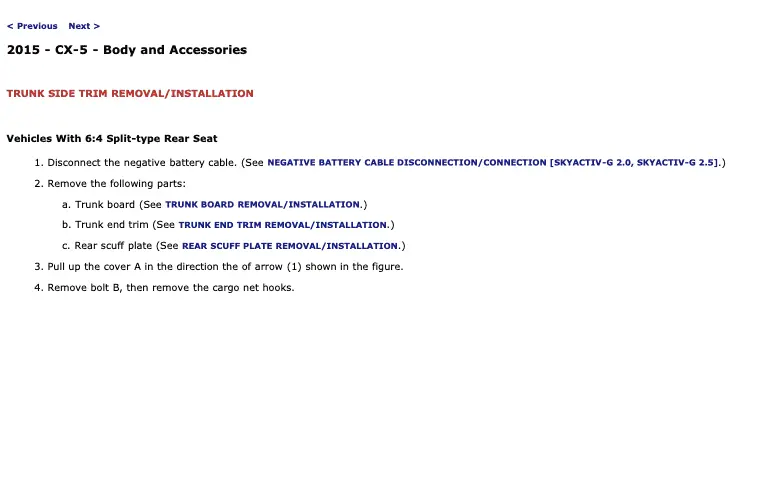

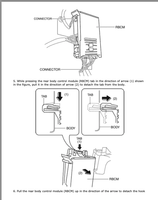

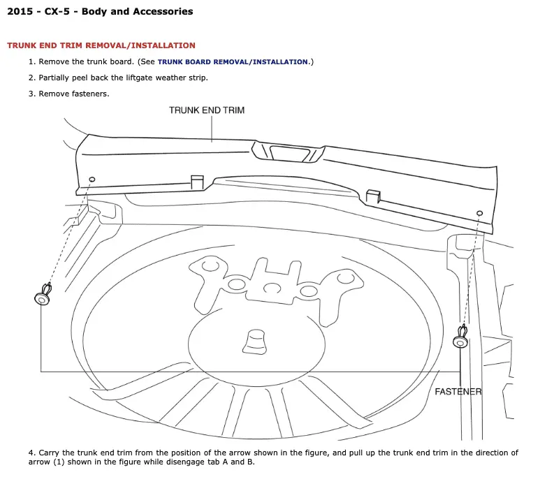

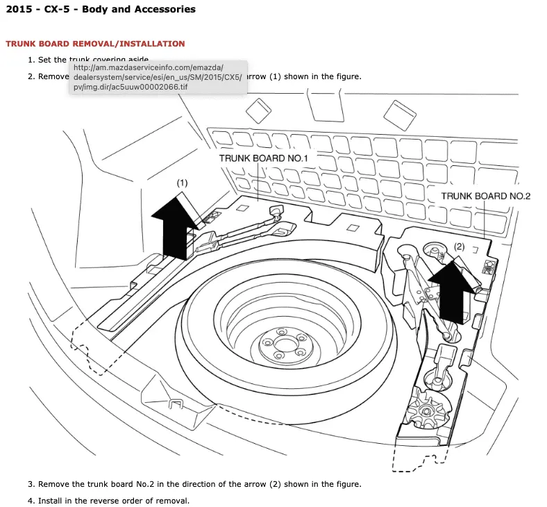

I’ve seen some relatively cheap used ones on eBay but FSM shows it needs to be programmed for vehicles with native Mazda OBD tool.. (or 3rd party programmer if anyone knows?)
I do see some for less than $50 with 30 days return warranty. I was able to dump the configurations of my current rear BCM with the forscan tool that I have now. I just want to see if the replacement rear BCM fixed the locking issue before I do any programming.
