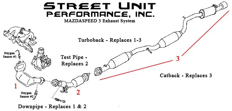

Those two resos and the muffler are all straight through designs, so there will be little or no power gain in taking those resos off. If you then go with the 3 inch DP/RP and just have that muffler at the very end, there will be a lot of loudness - "arrest me now, Officer Smith" loudness, I would think.
I'm not sure the resos can be removed from the stock exhaust without hacking it up and having to weld or clamp sections of pipe back in place of them. A good performance welding shop can do that, I guess.
Here's a good diagram of the whole exhaust system from SU's web site (I've never bought anything from them).
