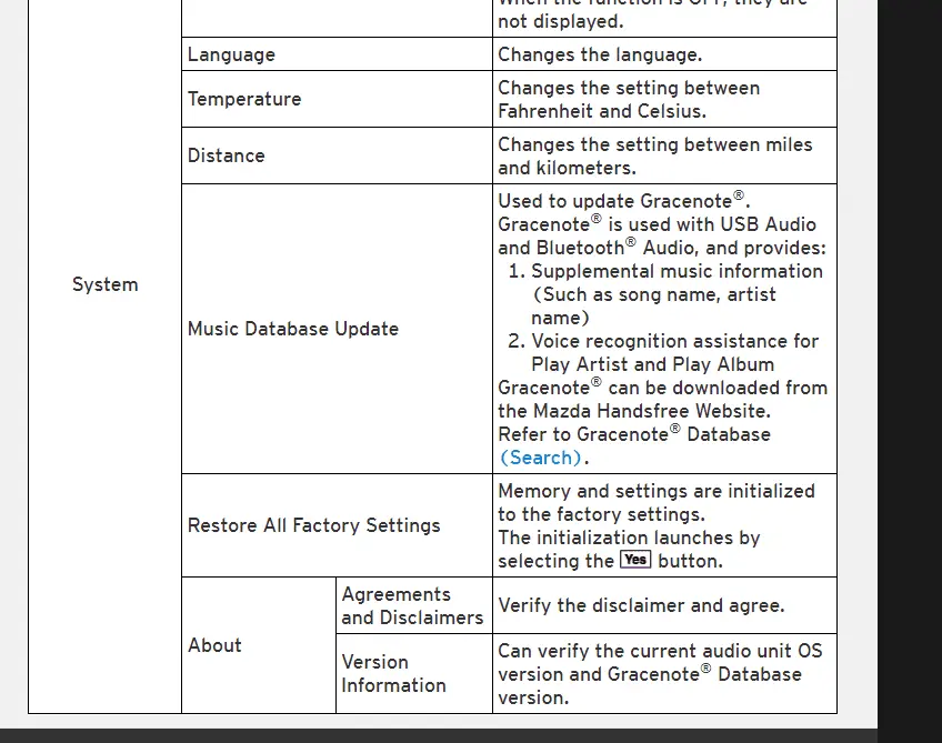

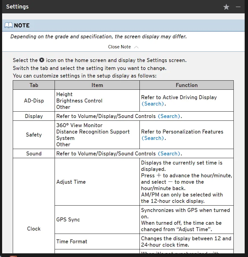

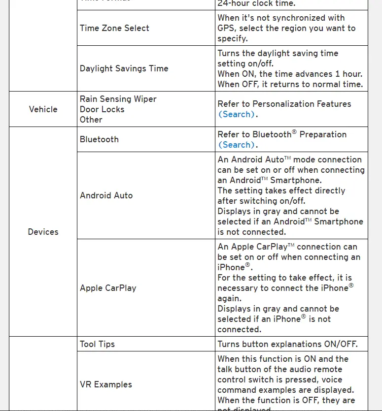

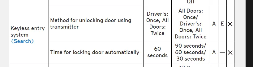

From the interactive manual, you want SAFETY --> Advanced keyless entry system
drill to keyless entry system

As noted in the images posted above, you have the option to change the length of time that walk away lock engages from 30s to 90s. I wanted to ask, is the car locking faster than 30s? If so, I'm thinking it's because your key fob may be dipping out of the proximity sensors' range, triggering the walk away lock. There is no proximity sensor at the front of the car, so if you walk around the front after closing the driver's side door, it might lock as you pass the side mirror.
Try walking around the back of the car to see if that changes anything.
