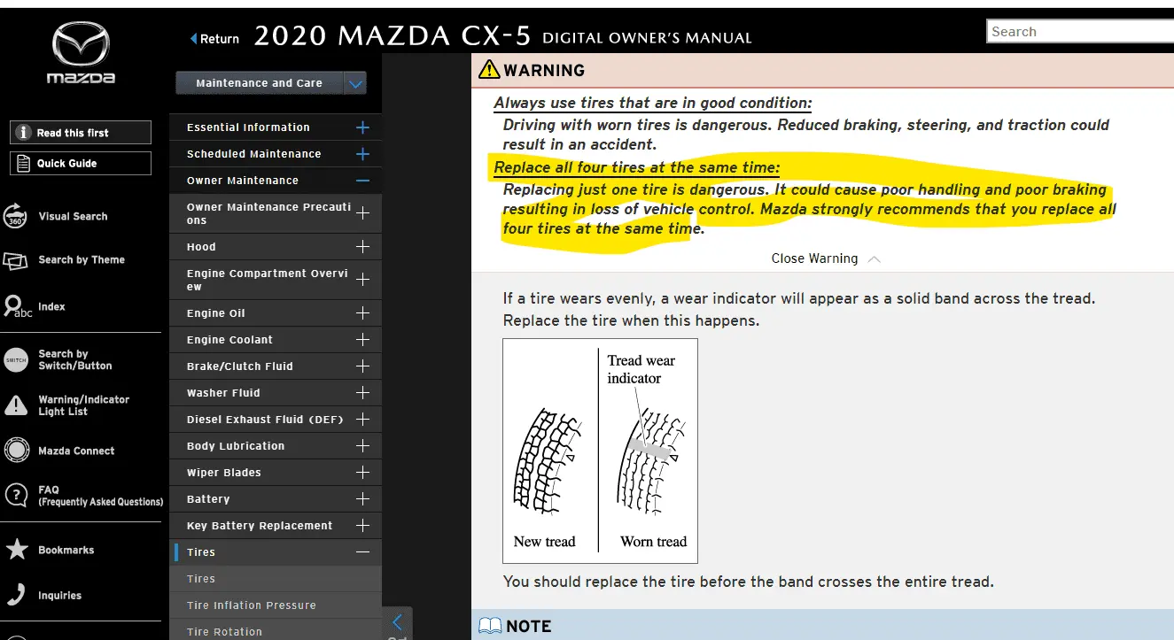

Mazda recommends all four as shown below:
I think the Mazda recommendation is to negate any legal liability. Even in the most extreme case where you have one 100% brand new 10/32" tire and one completely bald 0% tread tire, the diameter difference is 1%. -My personal opinion- the awd is not engineered to the rocket science level that it cannot tolerant the most extreme 1% difference. Baseless opinion so I could be very wrong.
