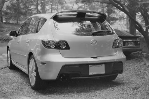

I've got no pics of my engine bay! I don't have a digital camera at the moment, but I do have some pictures of my car, right after I washed & dried it..
