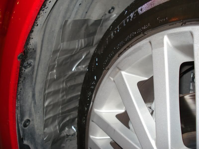

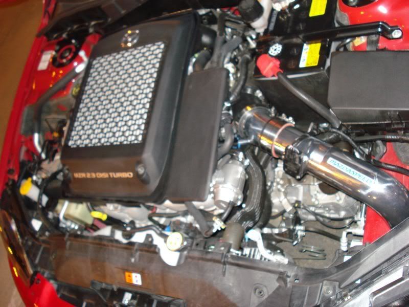

Took some pictures of the car and the install have fun
Engine Bay
Duct Tape Air Intake
Special thanks to SU for the BOV and for Tiffany @ Showcase she's the bomb got the CAI as a group buy price!! Wooohooo!!!!
im not gonna lie, im not likin the duck tape too much.
makes an otherwise clean mod look very ghettooo.

duck tape
why did you duck tape the vent to the cold air intake???
have there been know cases of that vent causing the intake to take in water,
