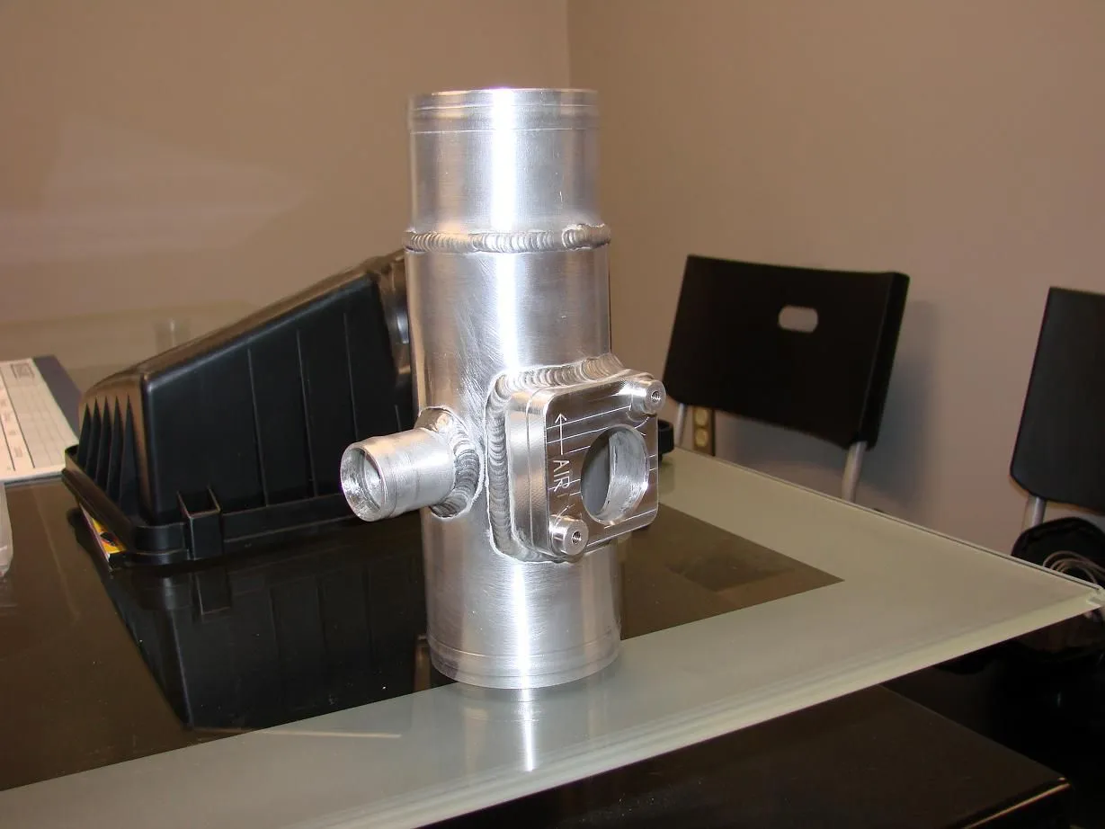

For everyone looking to do a custom intercooler or intake setup, we'll be testing a MAF housing this weekend we think will do the trick. After common complaints about the ATP one throwing check engine lights and causing fuel trim issues, we've made a good effort to engineer what we feel will be an all inclusive unit.
For starters, the diameter and MAF flange are based directly from dimensions matched to the stock airbox. Air straighteners are welded into the inlet of the MAF housing for proper airflow into the chamber. Unlike the ATP housing, the ventilation hose fitting is provided and welded into place for connection to the factory hose. The outlet is stepped down a size so that one can connect a simple 45 degree hose to the factory or aftermarket inlet (such as the RPMC).
If you are interested, let me know. It will be priced well enough so that people can choose thier own hoses and own filter and still be more cost effective than any short ram intake currently on the market.
Now Available for ordering;
edit - http://siteground207.com/~protegeg/product_info.php?products_id=1537

Excellent idea Ken,
Get to choose the filter of your choice....
I would like to see pics of the air straightener.
Have you run it on an MS3 yet and checked the LTFT's?

i will be testing it over the weekend at which point it would be available immediately

as a full kit with the hose and filter, it will be cheaper than a Cobb SRI and therefore cheaper than the Nano. on its own, the housing will be under $100.
Dam Ken, this would be great, but I need the inlets to be 3 inches for it to fit my corksport inlet, and air filter. Sorry, Im a needy person.
