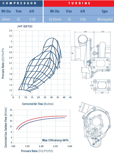

They nicknamed it the disco potato, long story short, because Garrett made a custom gt28rs for a early 90's Sentra awhile back. This Sentra had some sort of "chameleon" paint job or something that was a mix of purple, gold etc. Basically it had a "disco" look to it, though I don't remember the potato part. I believe it was some guys at Nissan in a certain division, that had a friend at Garrett. They got their friend to make this custom gt28rs for the Sentra, and it's said they used that Sentra for changing the minds of the executives when they might have felt like killing off a Nissan sports car or anything else along those lines. They'd take them for a ride in the "disco potato" and scare the crap out of them! ;) They had the whole story in SCC years ago.
Full story from Sport Compact Car: http://www.sportcompactcarweb.com/projectcars/0306scc_projsilvia/
The Potato portion comes from the shape of the compressor map:
Picture of the Disco Potato:
(rofl) Sorry had to do it, I'll have real pictures up by the end of the weekend, I promise.
