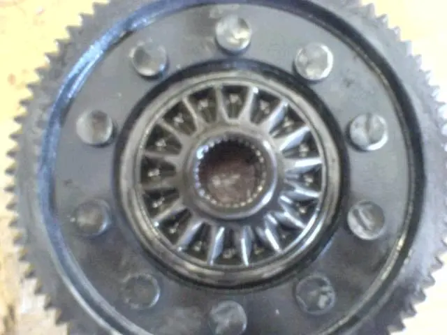

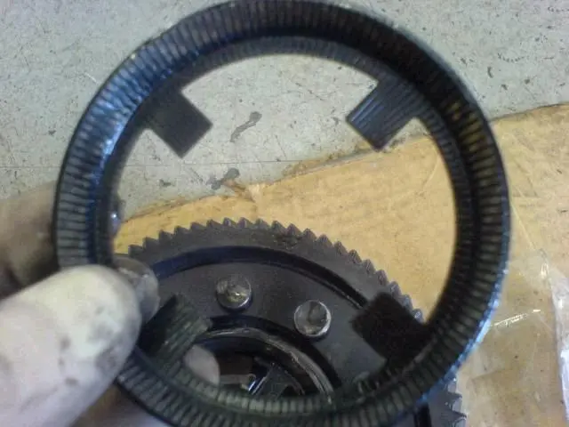

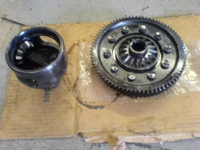

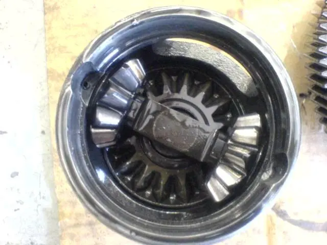

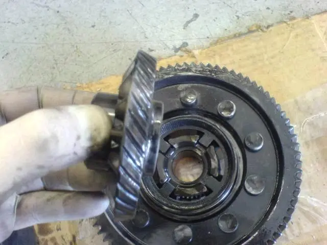

Opened up the tranny and removed the broken diff. It was cleanly split in half as I expected. The torque sensing rings and everything were held in place inside the diff , but they are worthless now. Nothing else inside the tranny was damaged.

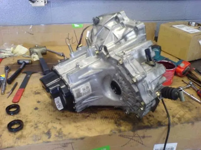

Tranny is all back together and sealed up! It will be going back in the car this afternoon.
wow the tabs on the last picture were completely gone on mine
Shame on you Scott, have you been launching at high rpms? LOL, JK. That is pretty strange, was your diff even locking up before it broke?

Nope, sorry, don't have one laying around, but I could get one within a couple of business days. Rick Case always gives us rush delivery on special order parts. Yeah, I know what you mean about the diff, it was bound to happen eventually. Those tabs probably got sheared due to the rpms when your diff broke. Mine broke while gently beginning to pull away from a traffic light (first gear, very low rpm). I immediately knew what had happened, threw it in neutral and coasted into a parking lot. That's probably the only reason mine were still intact.

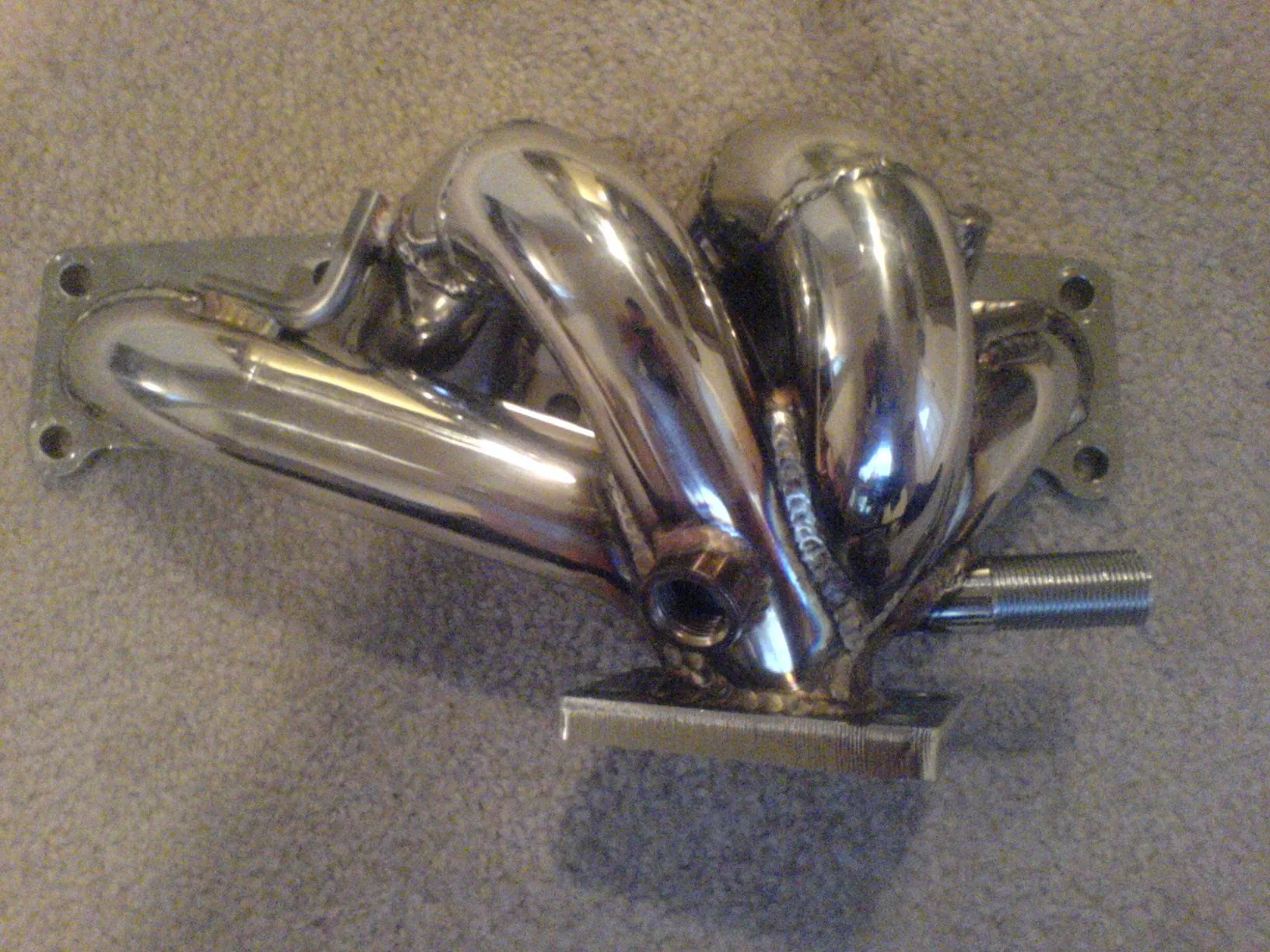

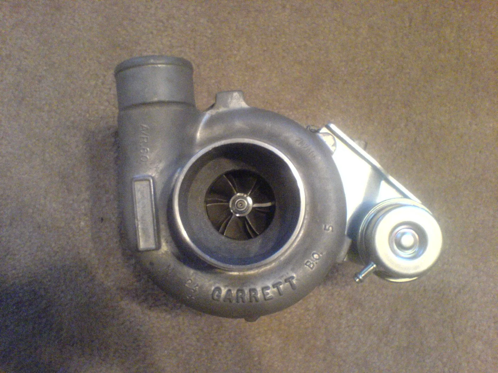

This stuff is really cool to look at and all, but I really wish my exhaust mani studs would arrive so I can get started, lol.

those were everywhere back when i used to live in ATL. 'things are some scary s***. don't let 'em near the turbo!! nice parts.
