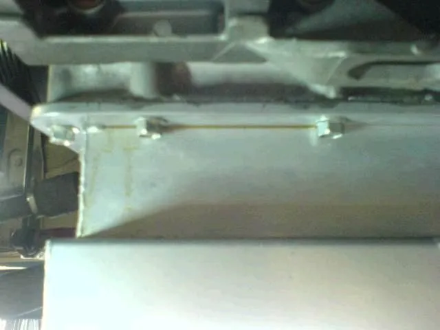

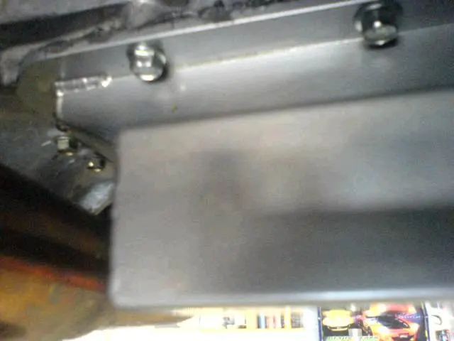

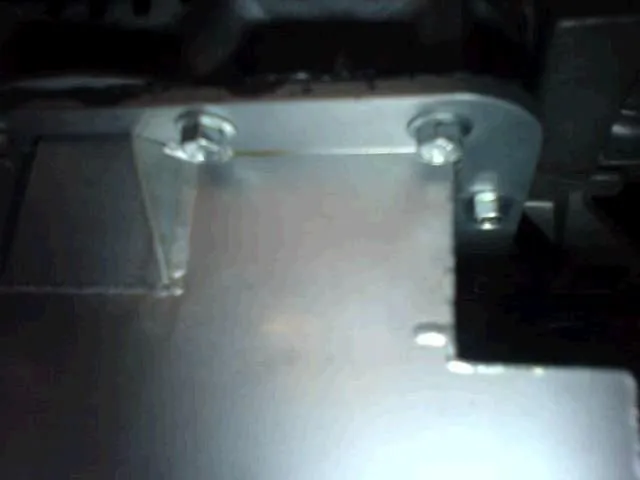

Pics of where the AWR oil pan is leaking...

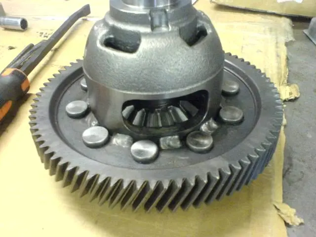

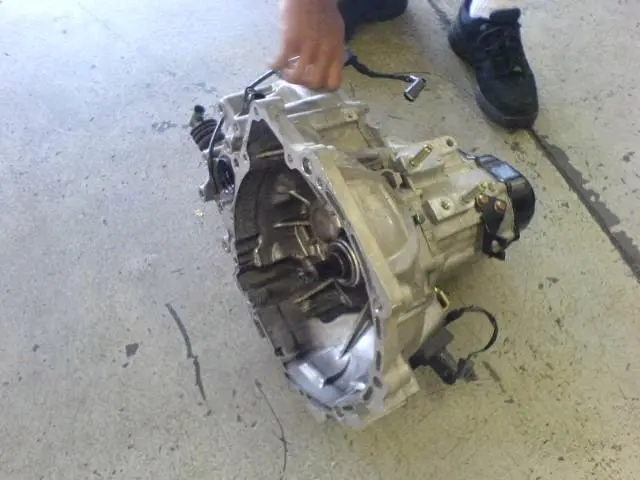

Well, tranny is on the ground and the diff is welded. Disassembly of the tranny has begun...

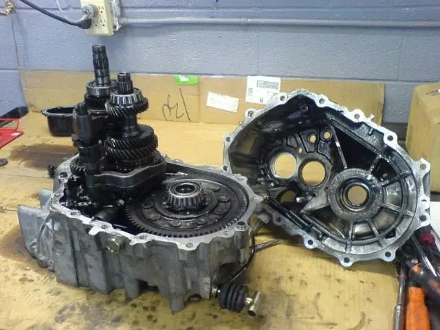

watch out for the plastic runner!
Yep, I see it. Being very careful and anything that gives me problems is getting replaced.
