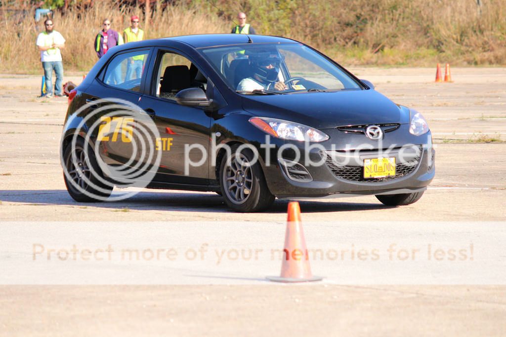

I have a Mazda2.
And a spare transmission. With plans to add a diff and change the final drive possibly. Depends on if I decide to run FSP or jump straight to SMF.
Its too bad I didn't make this plunge sooner, I lived in Dayton, OH up until last June.
I will be back next year for some autocross events though.
If you're interested in getting together some time to tear down transmissions and compare I'd love to do that.
