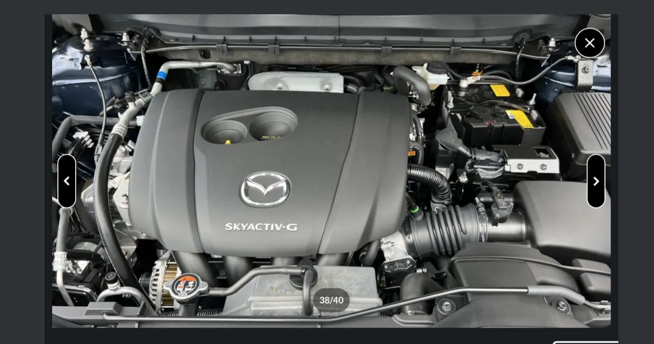

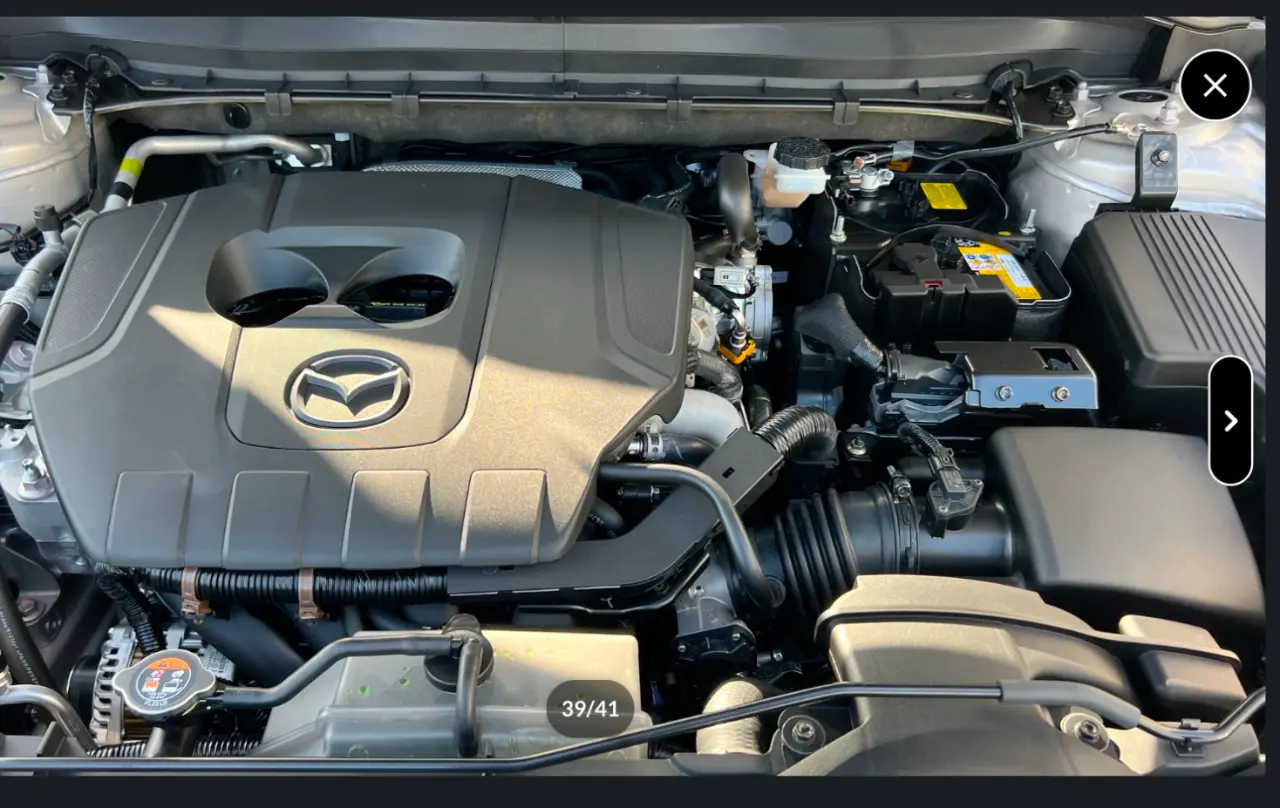

Was on another forum where it was mentioned that the Mazda put a newer updated motor in mid year different from the early 2025's. The mid year no longer has the Skyactiv G cover and it is larger. Attached 2 pictures from dealers website. Someone said that is the motor going into the 2026's.

Yeah, I saw that too. Would it make any sense for Mazda to put a new, upgraded motor in an outgoing 2025 model and not mention it at all? I have a 2020 Nissan Frontier which was right at the end of the production of the 2nd gen truck. They put the current drivetrain into the older body for the 20/21 model years as a test mule to work out kinks as the 22 is just a reskin of the previous generation (like the 2017 CX-5 was to the 2016 model), but it was listed and talked about on forums ect. I would think Mazda would have to tell owners what the motor was in the car if they changed it, wouldn't they? If it was an improved motor, wouldn't it be in Mazda's best interest to tout the new design? Plus it tells you what the motor is on the window sticker. Nothing points to a new motor other than a different, cheaper looking IMHO engine cover (which is just foam- it serves no purpose other than to clean up the looks underhood).

S,Pref and the Select trims do not have CD and I-stop.
PP has CD and I-stop and if I recall the engine now has EGR too (added). This needs the bit of difference in the layout and new engine cover too. All that started in 2024 actually not mid year for 2025.

Was on another forum where it was mentioned that the Mazda put a newer updated motor in mid year different from the early 2025's. The mid year no longer has the Skyactiv G cover and it is larger. Attached 2 pictures from dealers website. Someone on the other forum said that is the motor going into the 2026's.
Your second picture is the updated engine with cooled EGR, different cylinder head, exhaust manifold, exhaust camshaft and new intake manifold with tumble flaps.

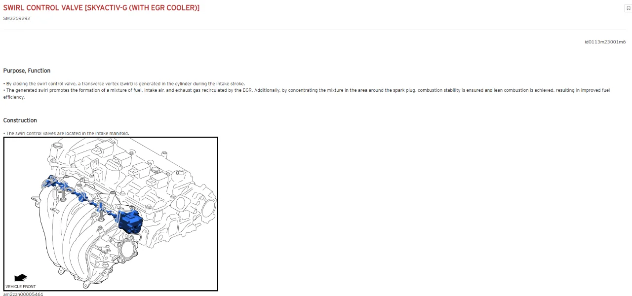

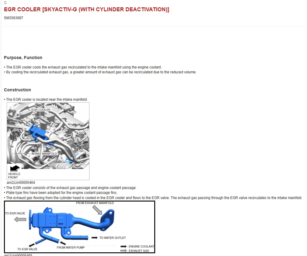

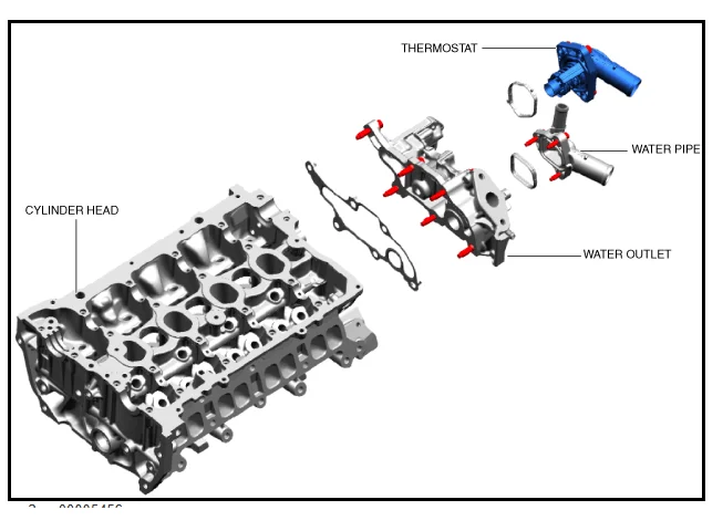

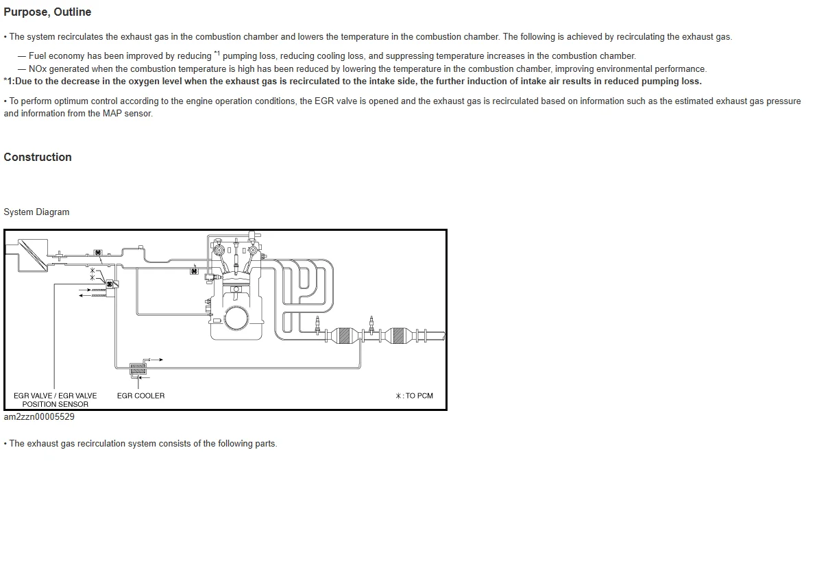

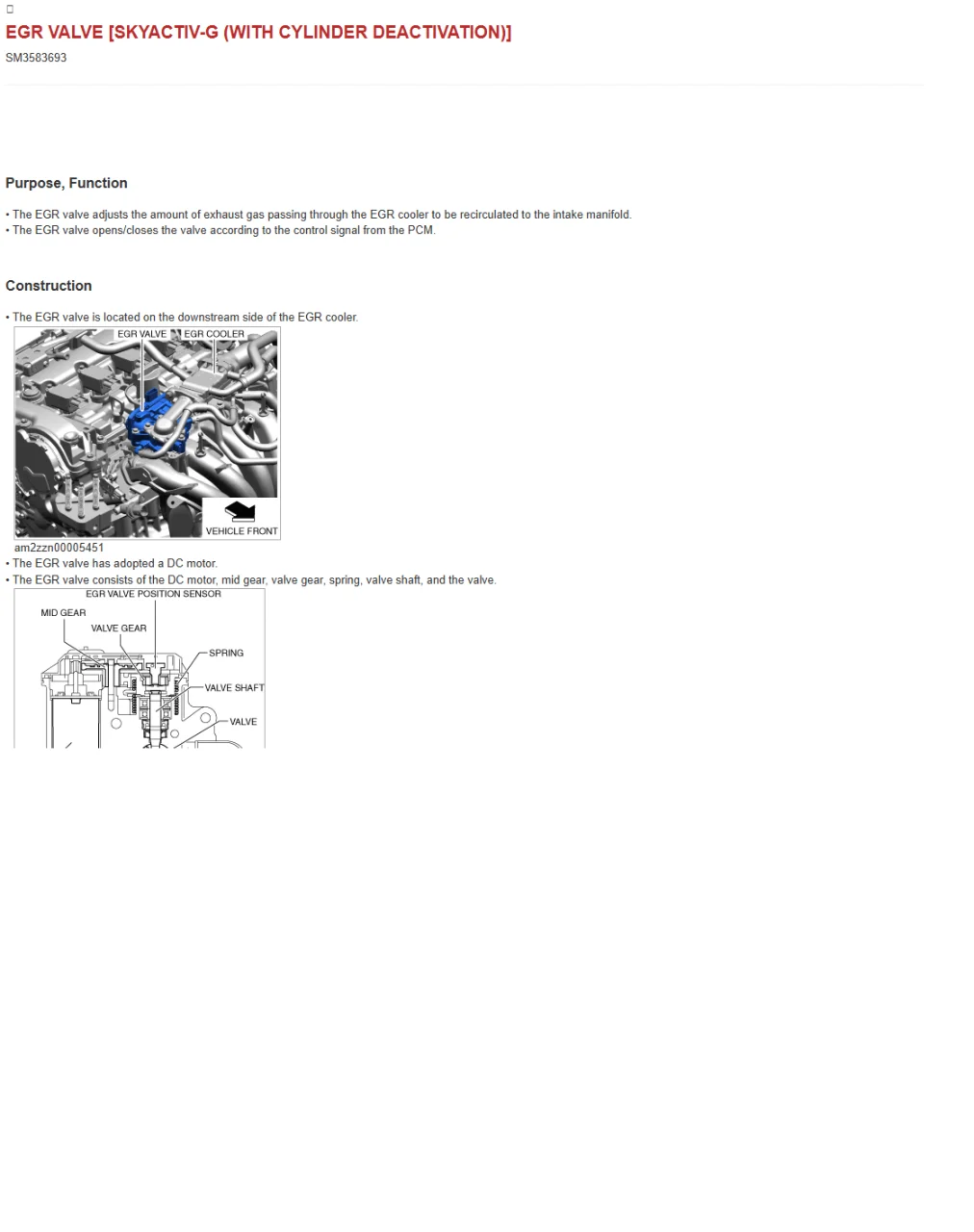

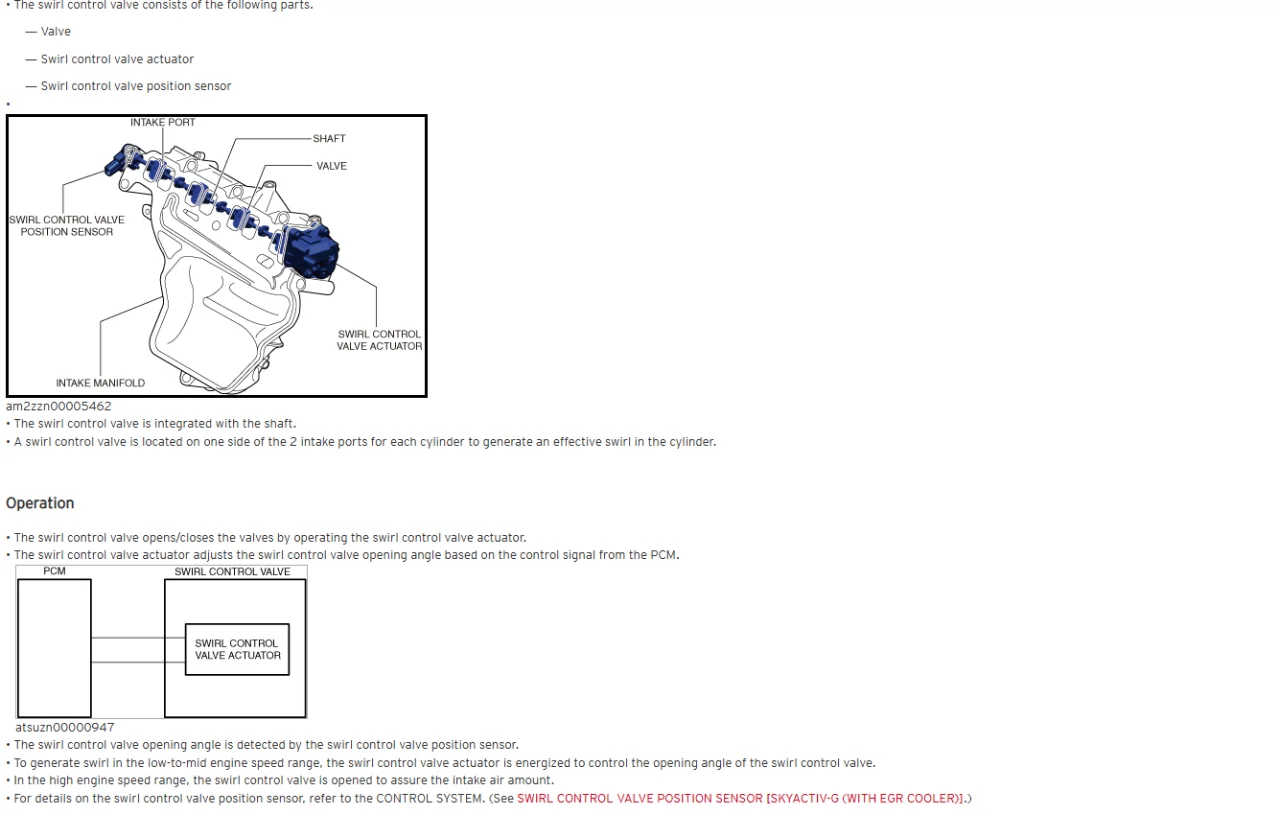

Here are some service info excerpts about the intake manifold and EGR setup

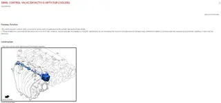

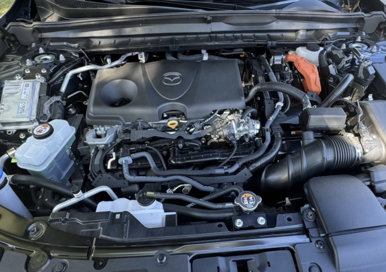

I got my 2025 NA skyactiv CX5 LATE in 2025 and mine looks like the pic on the left...NO cylinder deactivation
FYI, the Preferred model in 2025 did come with CD, as a rule. They are a handful of early production Preferred models that do not have CD due to parts supply issues. I know this from research. The Preferred model is the one I was most interested in because of it's incredible value for what is has in features but as the months rolled on it was harder and harder to locate any of these models that had the letter "L" (no CD) as the 8th character in the VIN. Most have the "M" which states that the engine has CD. There is just a few of them left now with the "L". I did further research about Mazda's version of CD compared to other makes and discovered that it is very simplistic and that issues with the system are uncommon. So, that opened the door to higher level trims for me. But to be honest, I'd rather it not have CD.
From what I have seen, non-CD engines have the old engine cover and CD engines have the new engine cover. I too see several minor differences in the engine bay between the two.
