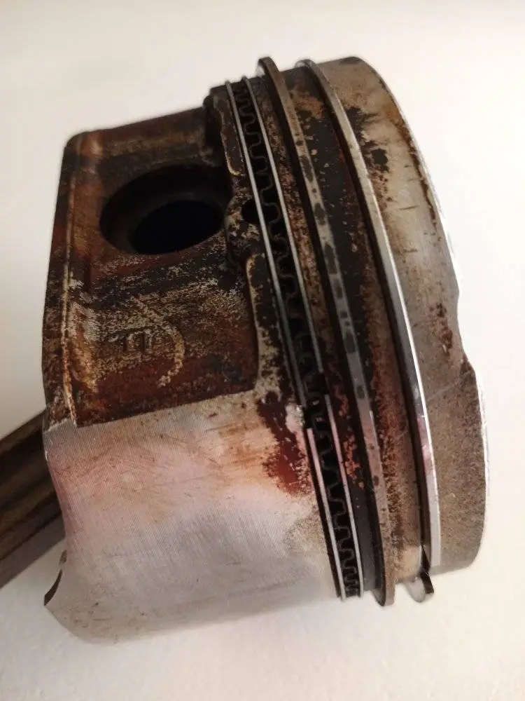

This is a picture of a piston from my parts car that was burning oil like a MOFO.
Notice how the oil ring has no spring tension.

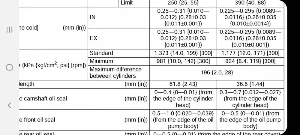

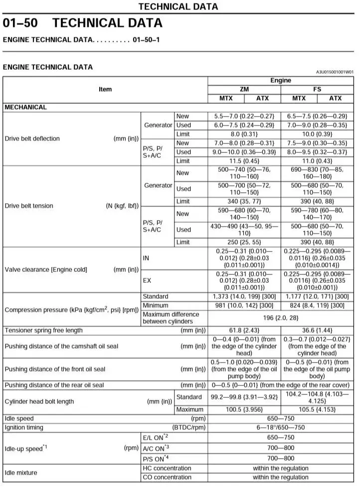

Your compression isn't quite right though.
The normal compression on a new engine is 171 psi with a minimum of 119 psi and a maximum difference of 28 psi between cylinders.
You probably have fouled combustion chambers that reduces the volume and increases the pressure.
