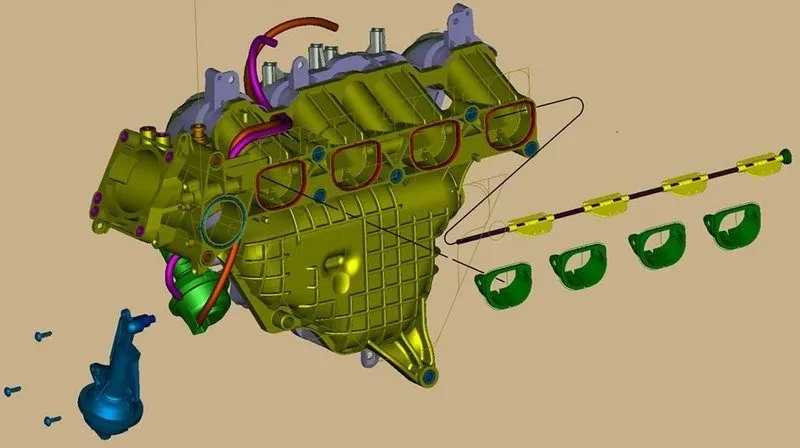

I have read a article from another forum that it show how to remove the Variable Control Throttle System (VCTS) from the intake manifold. I was wondering did anyone from here have done this mod? How's the fuel mileage after?

Yes it does actually. Is locatced at the intake manifold where it meets the cylinder head.
According to the article, I am suppose to remove the yellow parts in the picture, which is the valve. This mod are suppose to give a smoother acc and more faster throttle respond.

Yeah I did it! It's called VTCS Variable Tumble Control System. It's supposed to smooth out the air flow and torque curve. Very easy to do. How ever without a turbo I think it's kind of a waste of time. An hour to remove and I
didn't really feel any real difference.
I am about to do this mod myself. I had the intake manifold replaced under warranty because the VTCS valves were loose and really noisy. It is 6 months later, and the valves are loose again!! UGH! This time, I am just going to pull off the manifold and remove the throttle plates. This is mainly just to shut the motor up, but if there is any kind of performance benefit, I will be happy.

You are thinking of the VICS system. The VCTS system acts like a choke during cold, low RPM operation. It almost completely blocks off the intake runners when the engine is cold, and forces the air to "tumble" as it enters the combustion chamber. This allows for more complete combustion while the engine is warming up. It is basically an emission device. But, it also partially blocks the intake runners during normal temperature operation.

Well, I removed the VTCS valves on my 2.3 Mazda3.
What a mistake!!!!!
In any temperatures near or below freezing, the car is almost undrivable until the car is up to near full operating temp. The car bucks, and sputters until it hits about 4000 RPM, then it just takes off. Driving in snow out of the driveway is almost impossible. Either the car just sputters and falls on it's face, or it just goes WOT and spins the wheels. After it fully warms up it is normal, but it is just not worth it. The benefit is barely noticable.
Also, my fuel economy has gone into the crapper. My last tank went down to 350km before the light came on, where before I would get around 450km before the light came on.
I will be putting the valves back in as soon as possible.........

I took mine out, but I live in Texas. After a cold start it idles a little high, sputters a little bit once or twice, then everything is fine. It was my understanding that the VTCS aided in cold starts, so I can see how you might have problems at those temperatures.
