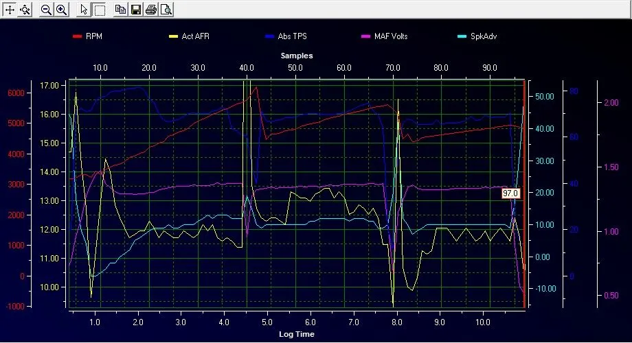

Here's my run from 3rd to 5th showing my afr lean a mutha in 4th but fine in 3rd and 5th. Weird. I hope its off too - maybe not with the DH but the ecu may not be reading it right and just reporting bad numbers to the DH. In any case, the timing is largely the same in all gears so I'm not knocking (pray). That and Driver's info make me feel (a little) better.
