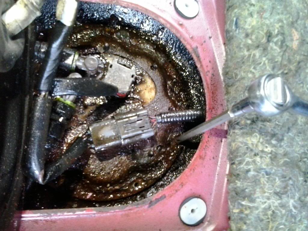

...As long as it doesn't look like this...
Thank goodness mine isn't that nasty; I took a look at it last year, and the only particulates in the way of the sending unit cap was just plain old dirt. Cleaning it off revealed a rather clean cover, but because I wasn't thinking, I got my interior all dirty because I blew it out with an air compressor. I was coughing and wiping my eyes, and when I could see again, I had to vacuum my car lol
