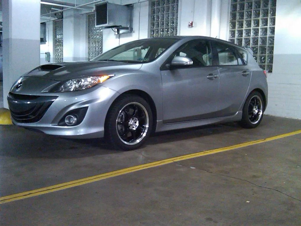

No differences between brakes between the years. Offsets noted in previous posts are accurate; however, lower ones will work (just bump the wheels out a little from stock, but then its a narrower tire so its not a biggie). You really are overanalzying this a bit - same specs as 07-09 so just roll with ANY of those combos and you will literally have ZERO problems. I got mine from Discount Tire and they been on for nearly 2k miles with no problems. I'm running a set of 215/50/17 Dunlop Wintersports (got them from a "client" haha) and they are a great performance tire that handles light snow/cold weather crap very well. I'm pleased!
Here are mine:
http://www.discounttiredirect.com/d...2009&pc=79646&counter=1&wd=17&rw=7&vid=015311 (they are a 42mm offset, no problems AT ALL so please dont worry!)
Here they are in just silver:
http://www.discounttiredirect.com/d...2009&pc=73139&counter=1&wd=17&rw=7&vid=015311
Oh did I mention that they are cheap as f@#k! $399 shipped with gorilla lug nuts, hub rings and new valve stems!
