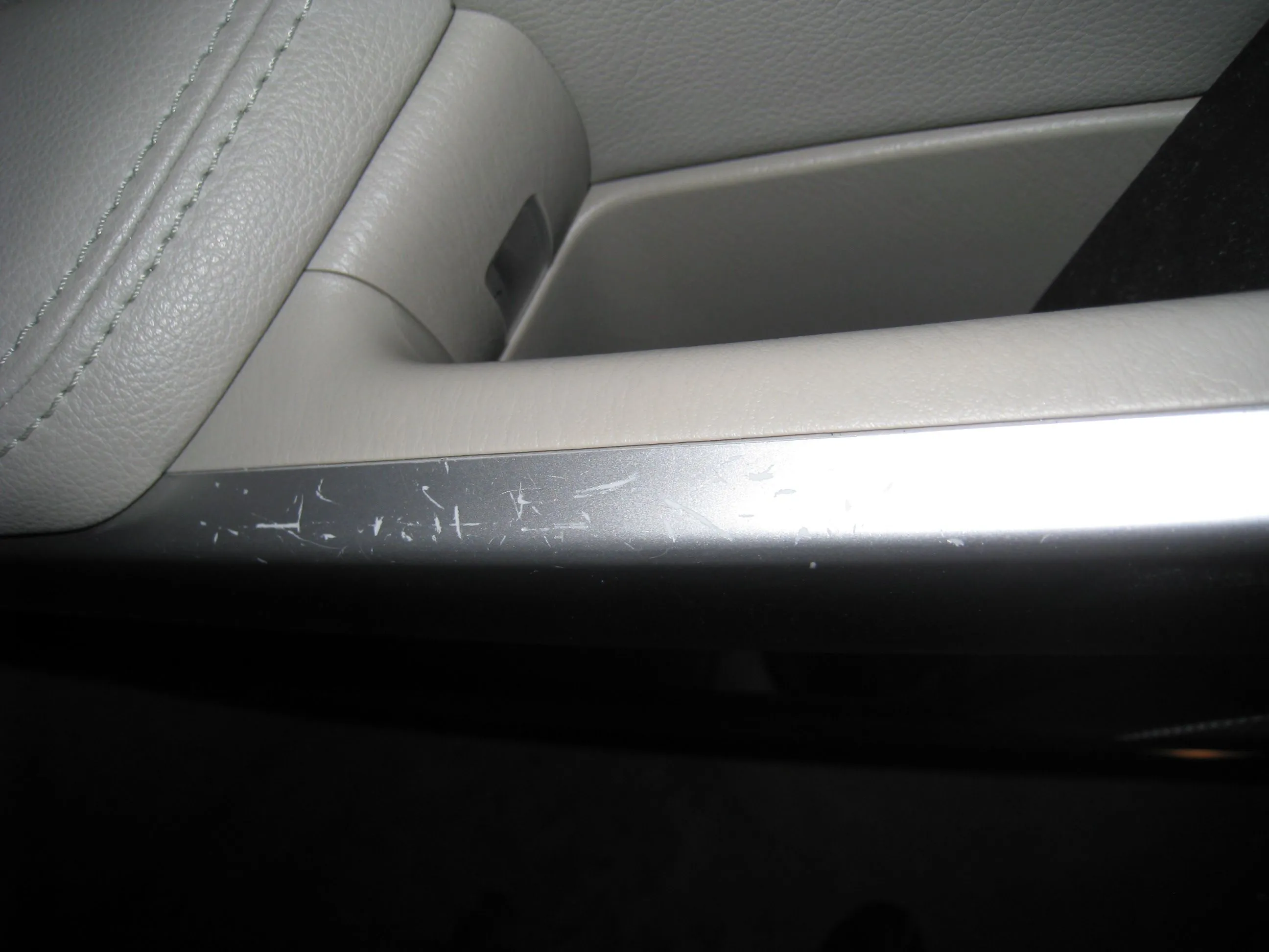

I am having a quality problem with the interior door piece on my CX-9 and wanted to find out if anyone else is having the same problem. I have a 2008 CX-9 AWD GT with 8K miles and less than 5 months old.
A few weeks ago, I went out of town, and let my wife borrow the CX-9 (yeah, I gave her plenty of warnings about where to park.far from everyone else). When I returned, I found no dings or damage on the outside of the car, but I did find the interior door handle all scratched up. I am referring to the metallic finish, plastic piece that runs the horizontal interior length of the door and is used for opening and closing the door while seated inside. A.K.A. The door handle.
We have no dogs, cats or even kids so this could not be from them. What I determined was that the scratching was caused by her wedding rings or fingernails as she climbed in and out of the car those few days. I saw similar (but not as much) on the passenger side which she is the ONLY person to ever use that door.
While getting my thoughts together to bring the car in this Friday for a few TSB fixes, I lightly ran my bitten fingernail (i.e. no real nail) across the plastic piece and WHAM! Instant scratch! I was thinking WTF!
If this is truly a door handle, as designed by Mazda, I would expect that this piece would hold up to many years of opening and closing without much impact. If this was truly a quality piece, I would expect Mazda to design this piece to withstand REAL fingernails on many different types of people. But what I found was a poorly designed handle, or one that was defective.
It is my belief now that this piece is defective from Mazda and clearly not designed well, or the production process on the date my handles were manufactured had a defect in the production line. Surely I should not be able to easily scratch this metal, with the slightest rubbing of my fingernail. Right?
I have attached a few photos of my door handle and would like to hear if others have experienced similar with their CX-9s.

I m in the same boat, my handles are like yours for awhile now, I thought they were aluminum, but it turned out they r just cheap plastic with a silver paint on it. Should mazda replace them for free? I think so, Will they replace them for free? I dont think so. What you can do is , just go to walmart and get a silver spray paint or a silver sharpie pen and paint the handles gently. I used the sharpie method but it looks even worse now lol. First it looked cool tho. After awhile u start touchin on it and the sharpie ink starts comin off. Maybe we should contact Mazda USA. Like you said they are not designed well, and as a former 929 owner I could say that my 929 was over 14 years old when I sold it and everything was fine with my car, even the door handles were steel and chrome finished and never got scratched.

I see I'm not the only one, my drivers side handle is really bad now. My 08 is 6 months old with 7k miles.
Just got back from my dealer.
They are replacing all the metal trim door handle pieces. Not a single question asked.
They said they had not heard of this before. however, I think if we all go back to our dealers and demand replacement, they'll get the idea that there is a quality problem. I just wrote a letter to the Director of Customer Satisfaction with photos and a short video of how EASY it is to scratch the piece with a finger that has no real fingernail.

After reading this thread I decided to take a good look at the door handle pieces in my CX-9. They still look as good as the day I purchased it, some 11 months ago. I was also unable to scratch them with my fingernail, and they appear to be quite hardy to me.
Perhaps there was a bad batch?

Very interesting. That was something that I had proposed to the dealer that possibly these were from a defective batch. It was just way to easy to scrape the paint off with the lightest of touch.
Do you have a 2008 or 2007?
The dealer called and told me they ordered all 4 pieces and will replace them when I come in on Wednesday.

Just got my CX-9 back.
She's in brand-spanking-new condition on her doors! All 4 pieces were cheerfully replaced. No questions asked by the dealer.
I recommend you all follow suit and put in your defect claim. Maybe someone upstairs will see a trend and do something.
