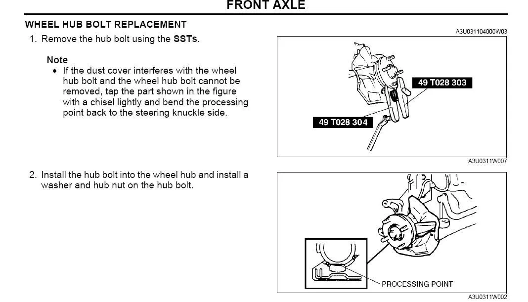

Here it is:
thewrench said:
Here it is:
Chollie, you're my hero. I'll go try that. Is the manual online somewhere, or did you scan that?

Yeah, Ben's ITR. You won't need a press to get out the old stud, just hit it with a hammer, but watch out for it WILL go flying! You will need an impact gun to draw in the new stud though. Washers and a "sacrificial nut" will get the job done, just make sure you stop once it seats.

I still couldn't get the stud in! (bang) I'll have to limp to a shop that can do it for me tomorrow. I am going to just have all new studs put on on that side while they've got the hub off.

What's the problem with the stud? Could you not draw it into the hub or could you even get it into the hub at all?
he's on a 4 lug, so he probably can't get to the back like on a 5 lug
Is any1 taking a car that they won't be driving? I may need somewhere to temporarily store all of my schwag during the race....u know, that pile of crap that was in front of my car last time...
EDIT: Does some1 have a "1" I can borrow? I've got a codriver this weekend
I can't even get it into the hub. There's no room to angle a full stud in. I had no trouble getting the busted one out, but then, it was only about half as long!
I found several posts where people explained how they got theirs in, but all of them were on 5-lug cars. I think the plate they mount in to is just smaller on the 4-luggers.
Oh, well, off to autozone for more studs, then to the shop to have them put in.
