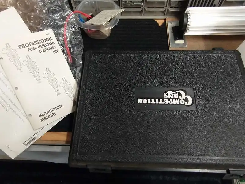

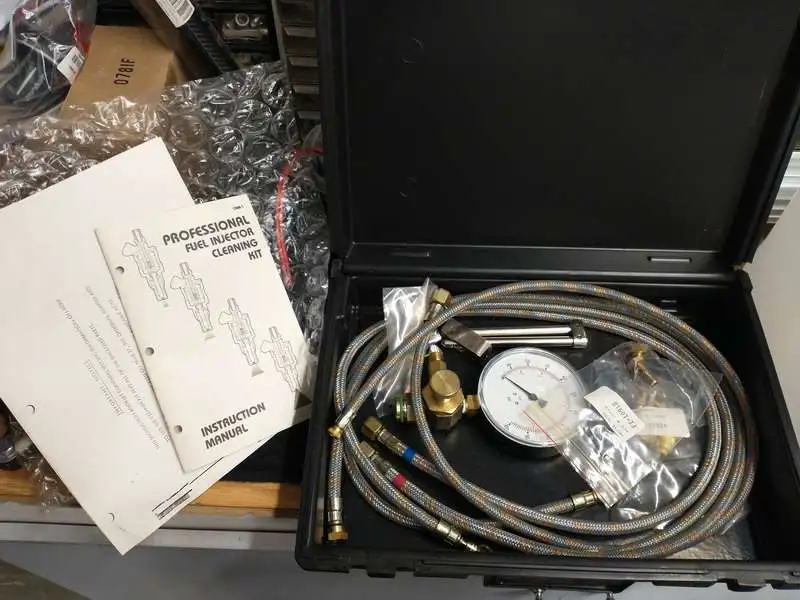

On my own personal Mazda I do a fuel injection cleaning every 10,000 miles my own equipment in my DIY home (not the shop lol) garage. . It takes me about 1.5 hours.
Upvote 0
What kind of cleaning kit and product are you using? I saw your kit says Comp. cams but they didn't show a cleaning kit on there site.
Upvote 0
speed3chris1
Sorry that can be confusing. It is a Comp Cam decal the case is the original tool case for the fuel system cleaner. The basic kit is a Techlit from the 80's which is no longer in business. The adapters and basic tools in that kit are pretty much universal. So if needed to do a service on something new is getting the proper adapter. There are a few professional Fuel injection kits offered from about 90 bucks.
This is not a recommendation because I like to try anything I recommend first but the kit looks nice and has everything for basic fuel injection services except the fluid cleaner that is usually needed on these type of kits.
