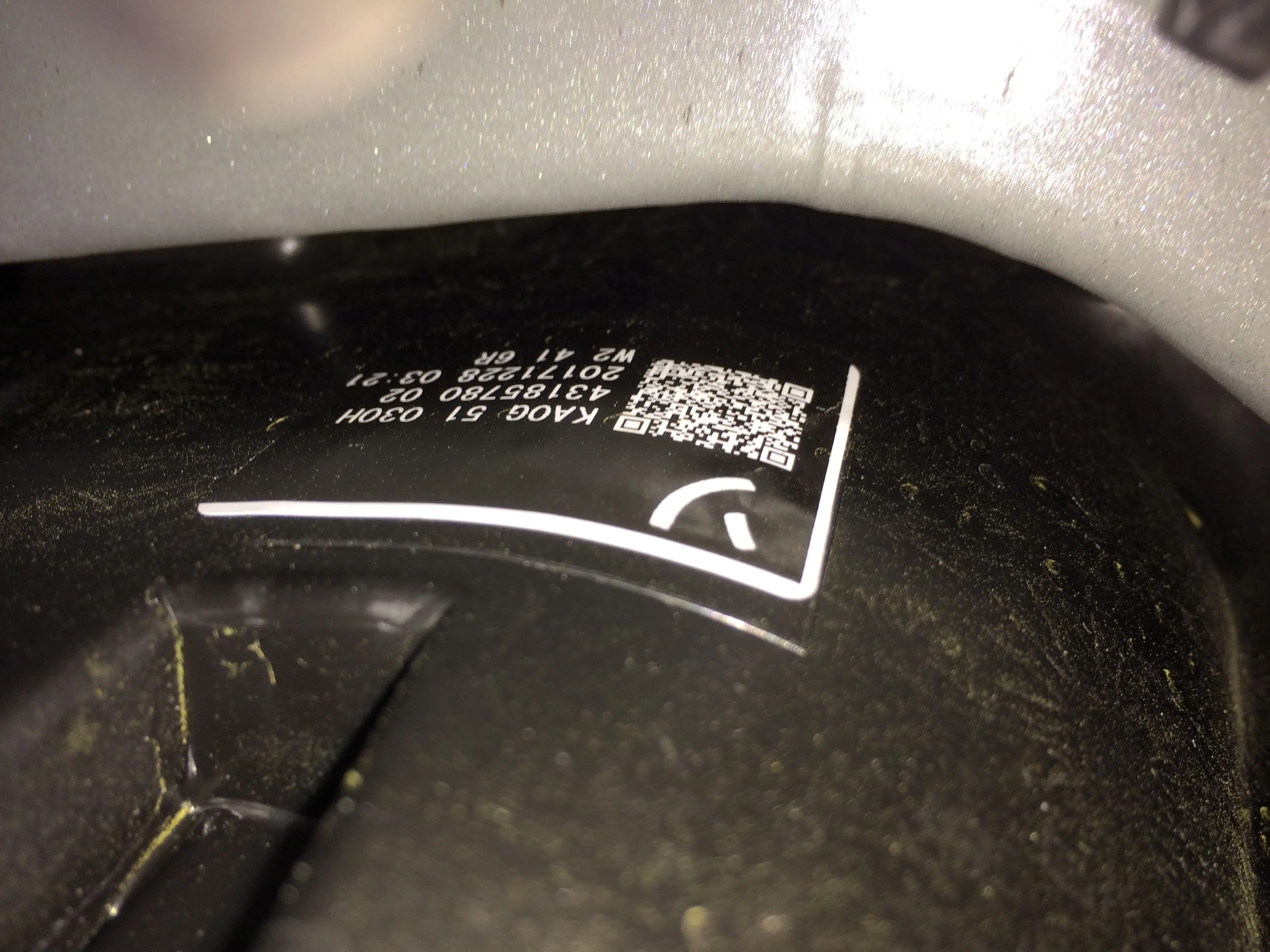

Wife just got back and its raining. Here are the info of my replacement LED headlights:
Passenger's side (installed 3/17/2018):
HL Sticker states: KA0G-51-030H (Manufacture date 12/28/2017)
Invoice states: KA0G-51-031J Unit (R), Head Lamp
attachment.php

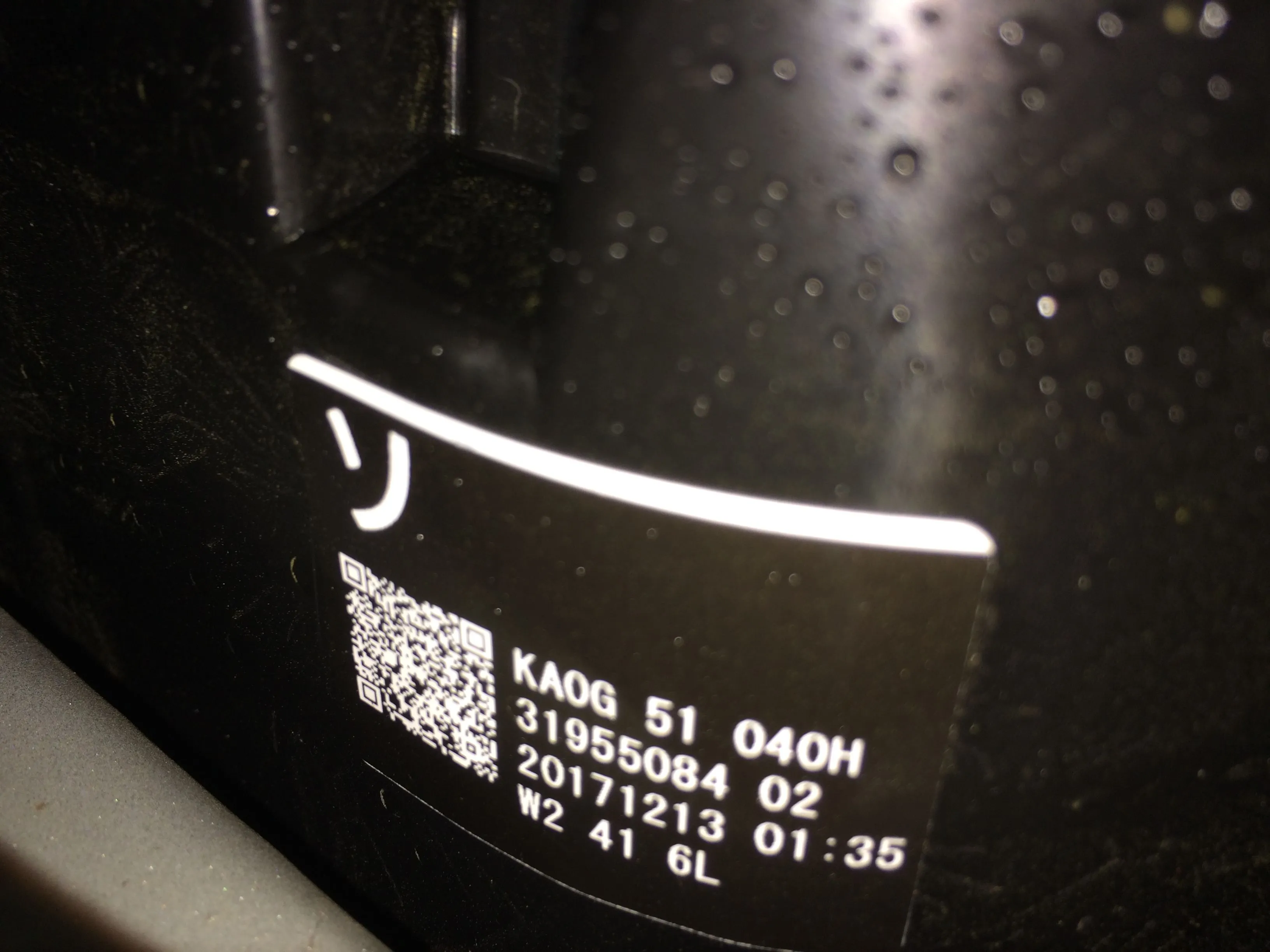

Driver's side (installed 3/17/2018):
HL Sticker states: KA0G-51-040H (Manufacture date 12/13/2017)
Invoice states: KA0G-51-041J Unit (L), Head Lamp
attachment.php
So your H version LED headlight seems to be the same as my J version after all. :)

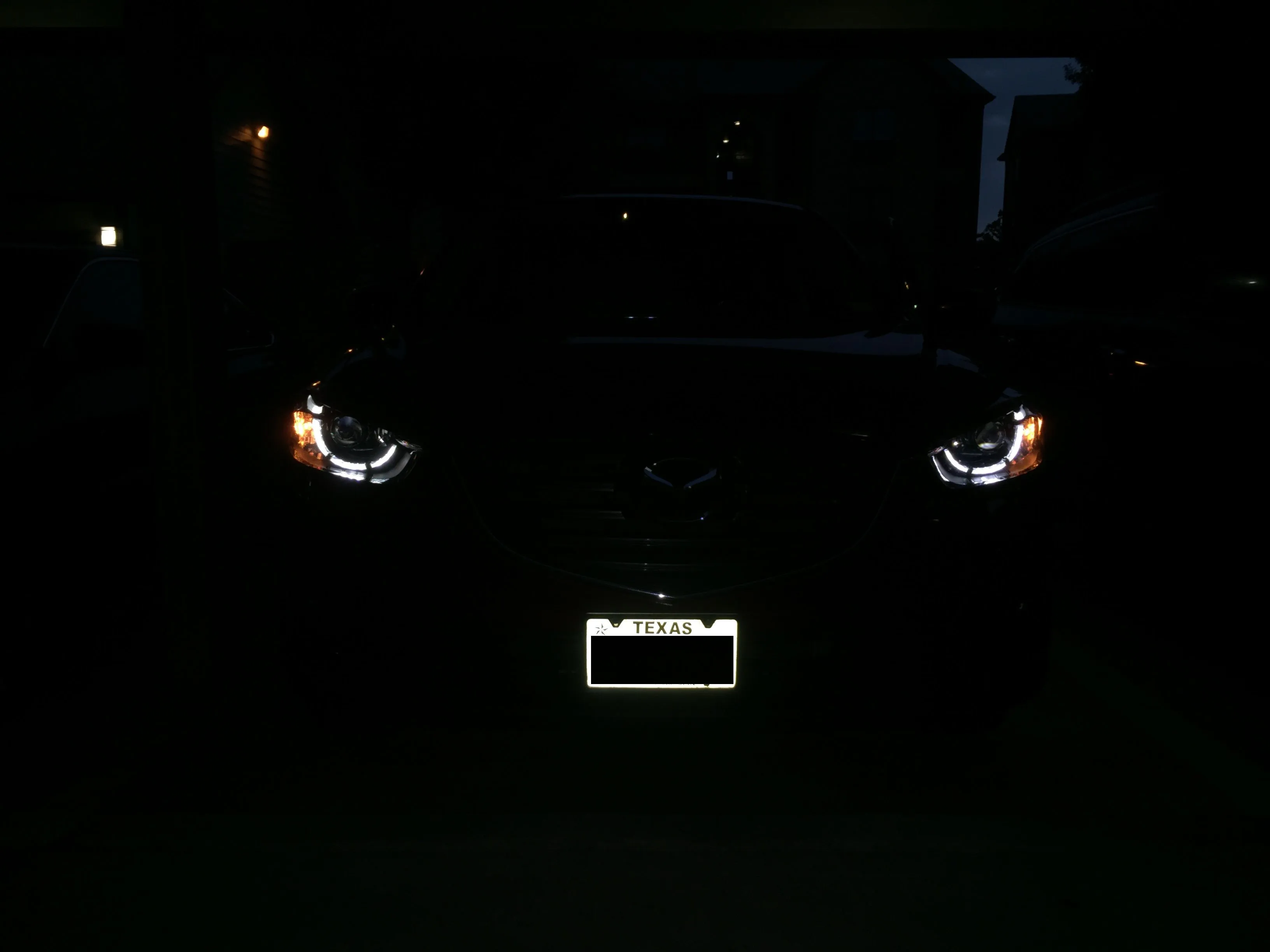

I looked at mine at night and the DRL look balanced on both housings. However, I definitely notice a slight color difference between my driver and passenger side head lamps.
I shined them against my white garage door at night and I can see the Drivers side installed today has a more yellowish tint compared to the passenger side replaced a few months ago which is more crisp white.
Sucks - I guess Im not sure if I want to push my luck for a third housing that may or may not be different.
Honestly, I like the older passenger side (crisp white) better.

Do you mind to check part numbers on actual label on the back end of replacement headlights? My "J" version headlights still say "H" on the actual labels. See pictures in post #143 above.

Checked and both lamps are H (even though J on invoice) one was manufactured in 07/17 and the other 11/17, main LED colour difference apparent, DRLs are fine.
