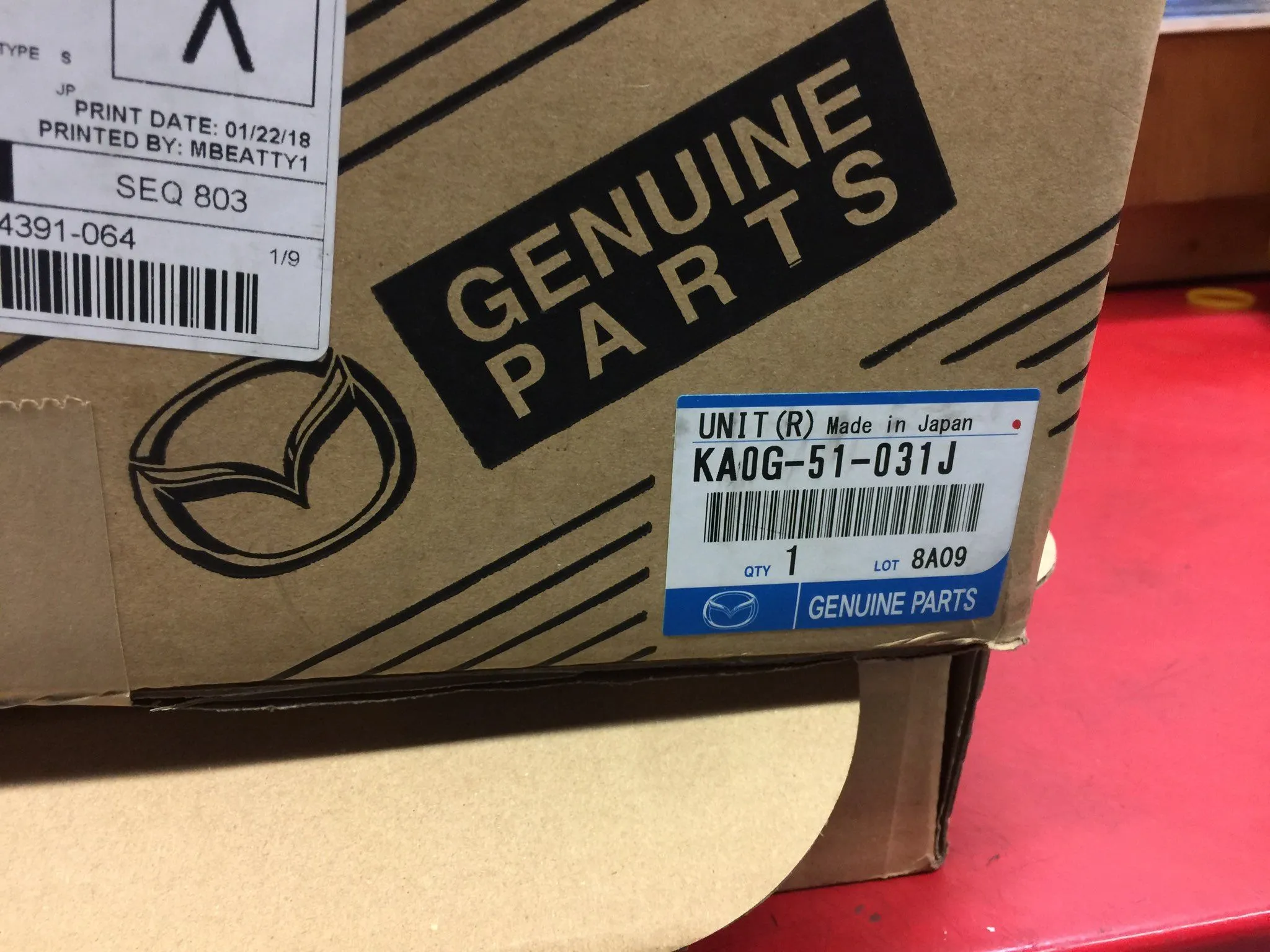

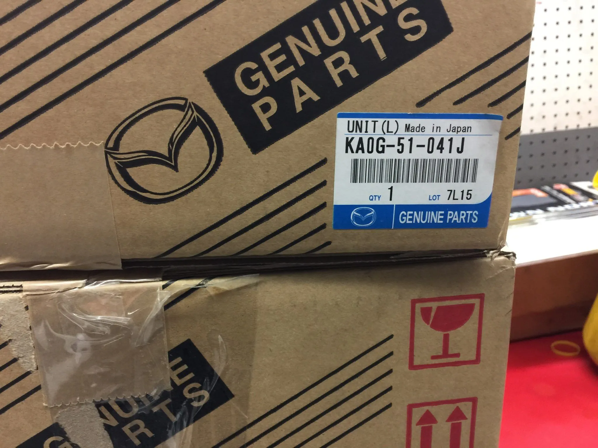

Got my 2016 CX-5 back with a new pair of “J” version LED headlights replaced under warranty due to failed accent LED DRLs. Mazda/Stanley actually has changed the hardware design of the accent LED DRLs as my originals use fiber optic LED accent light similar to BMW’s “angel eyes”, but my new ones now have many bright white LED “dots” which looks like most other LED accent DRLs. Of course I like smooth and more expensive fiber optic LED accent DRLs much better, but apparently Mazda/Stanley couldn’t overcome the reliability issue with fiber optic LED accent light for some reason and had to change the hardware design totally. Now I know why the MSRP’s on newer “J” version LED headlights are about $150 lower than previous versions.
attachment.php
attachment.php
How about pictures of the new LED lights on your car, instead of the boxes? I'm assuming it looks no different from afar?
We just got our CX-5 back after the full rear brake replacement with revised calipers. Wife has it at work and I'll take some pictures whenever I have a chance. Parts packaging do show a newer "J" version been put on our CX-5 making sure the ones we got are not any of the 5 previous revisions.
