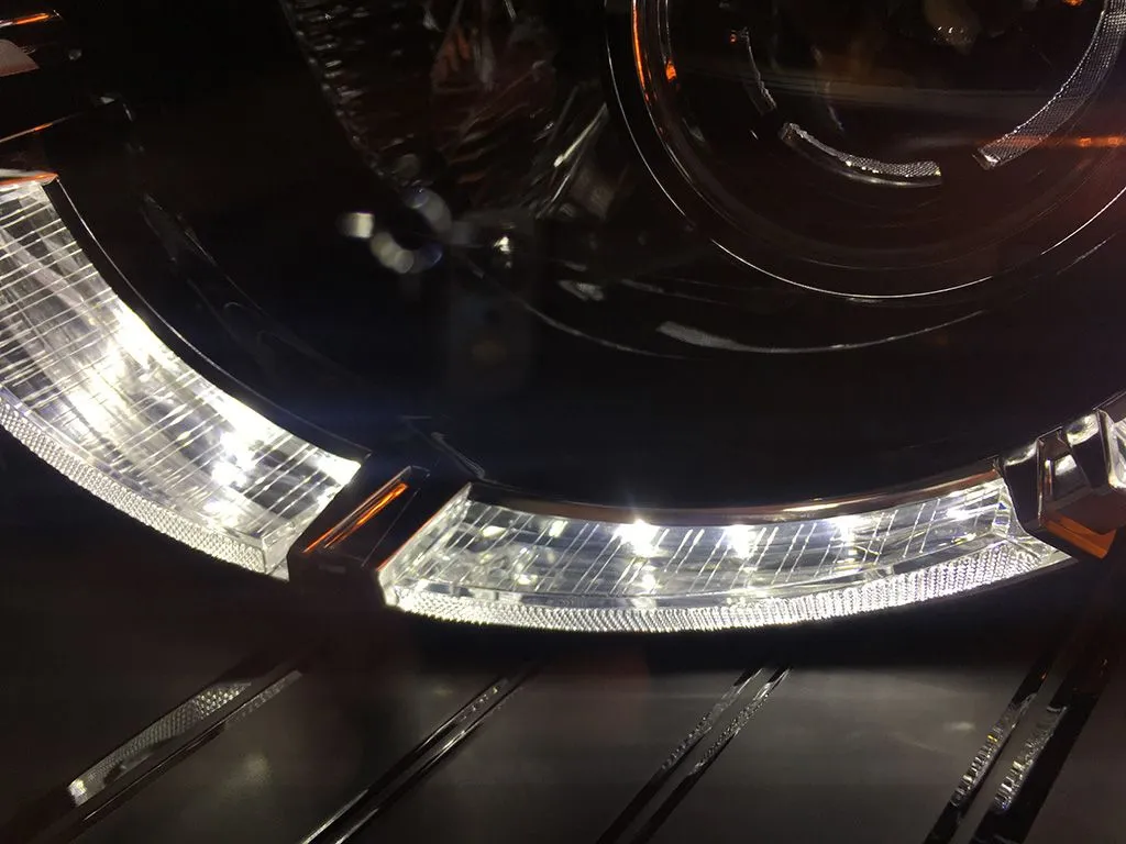

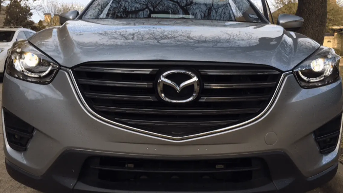

I was driving behind a recently-waxed black Silverado and noticed my driver-side DRL is very dim compared to the passenger-side. I checked it out at home and found the driver-side DRL is very dim and also flickering, while the passenger-side is very bright and steady. Since the car is covered under warranty, I took it to the Mazda stealer. They said the entire LED headlight module will have to be replaced under warranty and asked me to come back in a week so that they can order and receive the parts before the appointment.
Have any of you had this problem? I really like the LED lights and thought the tech package was a steal for the price. But if it fails so soon and if I have to replace the whole module whenever there's a failure, I am concerned.

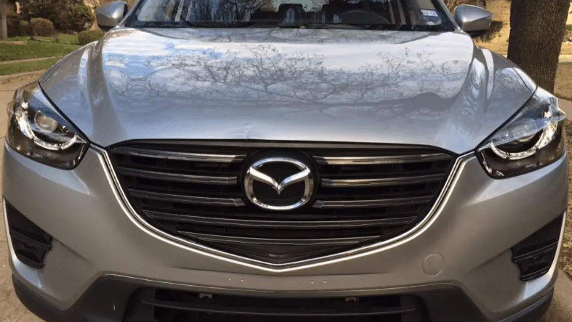

So quick follow up. I had the light replaced today - from what I can tell the new J DRL ring looks identical to the older H version on my passenger side - I can’t really see any noticeable differences in my dark garage - I’m going to look again tonight from a further distance.
However, the new J headlight (left on photo) seems to have a more yellowish color to it when compared the other side older H side (right on photo). I can see the tint difference when looking at the housing from the side and when looking at the wall projection. I’ll further evaluate this tonight but I’m uncertain if I should make a deal out of it.
My service manager told me to call him tomorrow either way if I’m happy or not, and if not he will get back on the phone with corporate and look into replacing the H version with the J.
I know sometimes LEDs can vary in color for the exact same part so I haven’t decided if it’s worth proceeding or not - especially since I’m at 65k, way out of warranty and they covered most of the cost with the first two.
I tried to take a picture of the color difference but it's hard with a camera. This is the best I got. I can see the color difference more on my iphone then on my laptop.

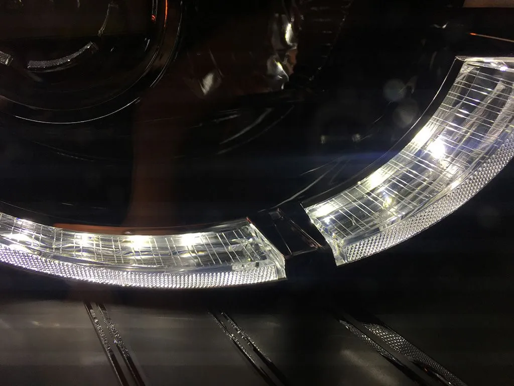

Can you see those white dots along the DRL accent strip on your "H" LED headlight?

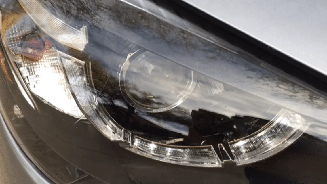

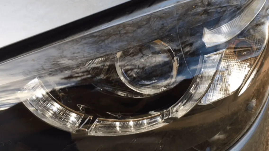

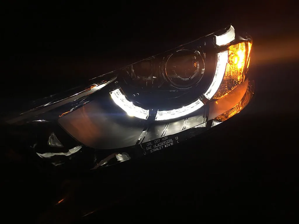

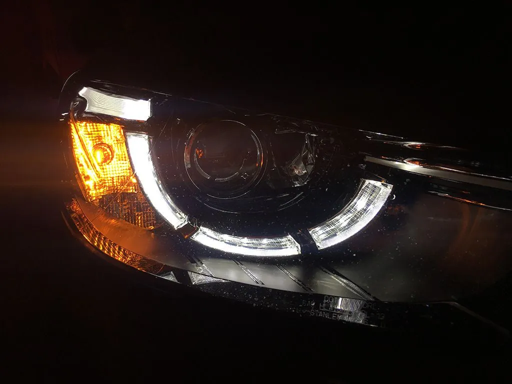

I took pictures of both DRLs if anyone is interested.
Passenger's side (installed 11/2017):

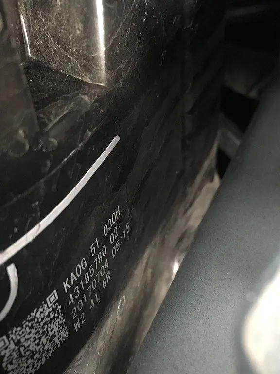

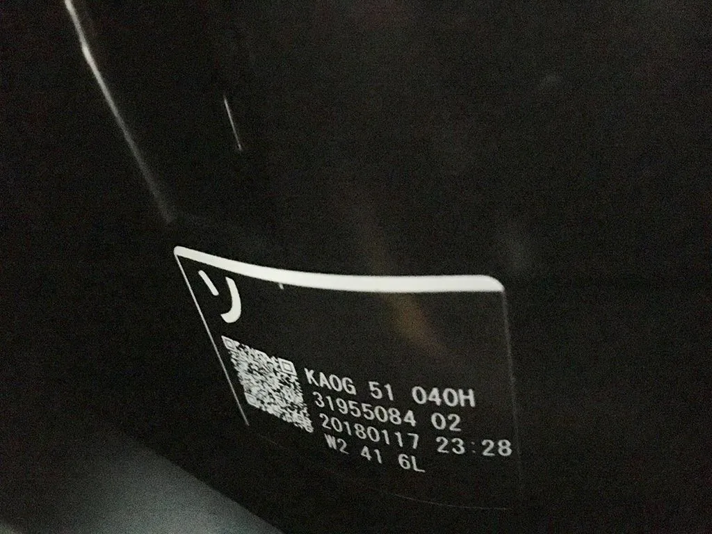

HL Sticker states: KA0G-51-030H (Manufacture date 7/2017)
Invoice states: KA0G-51-031H
Driver's side (installed 03/2018):
HL Sticker states: KA0G-51-040H (Manufacture date 1/2018)
Invoice states: KA0G-51-041J
I'm not sure why the part numbers don't match up - but both look to have the dot matrix DRLs and around equal brightness and color. The only issue I seem to be having is the newer one looks to have a slightly more yellow tint on the headlamp.

Here are the part stickers since I can only do 5 Images per post...
Where are the part number labels in your picture? Yeh the part numbers are wrong, and both of yours are "H" version? BTW the "J" version LED headlights are available as early as my post here dated on 8/21/2017:

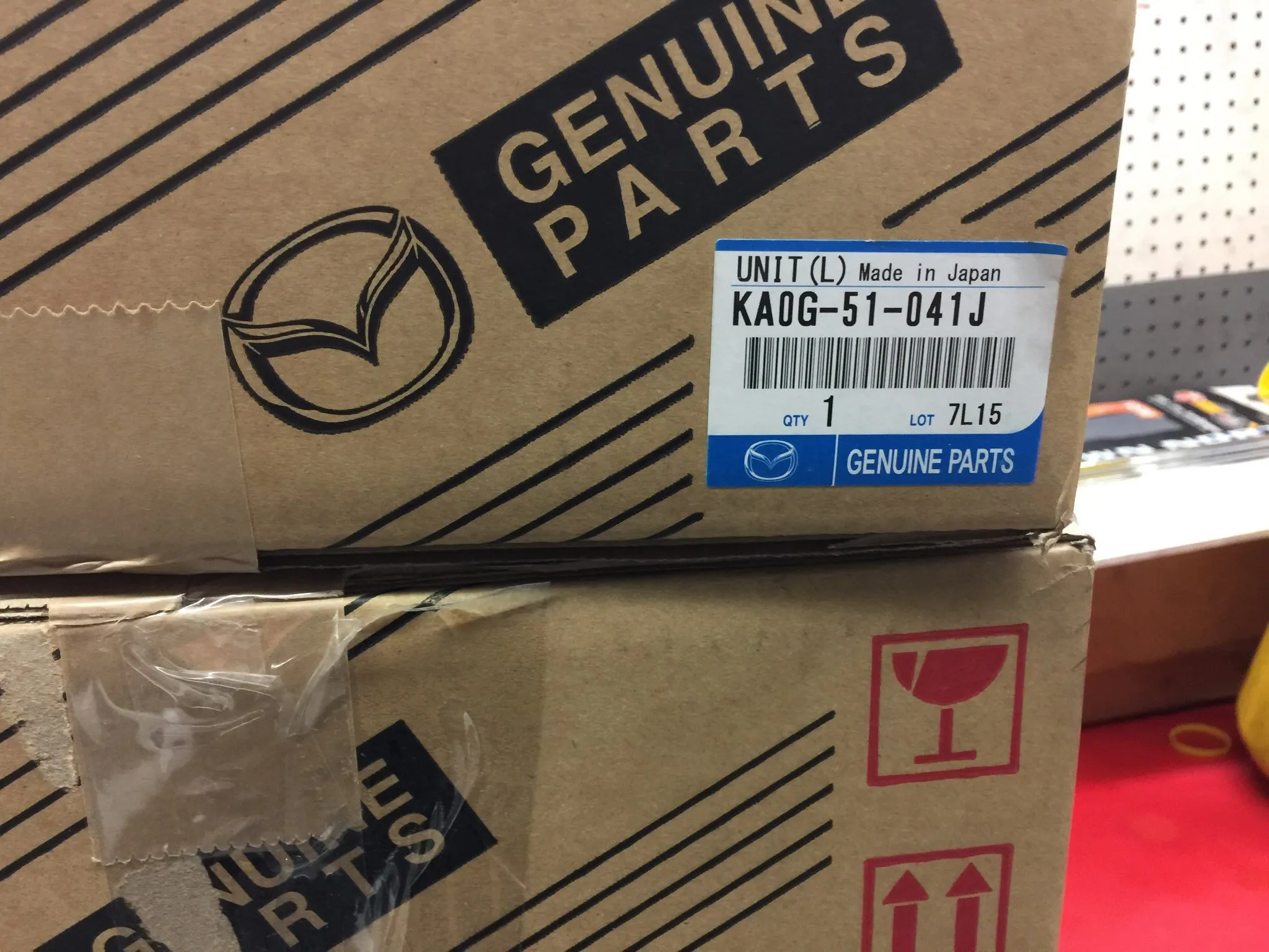

And here are part numbers on the box of my replacement LED headlights:
Got my 2016 CX-5 back with a new pair of J version LED headlights replaced under warranty due to failed accent LED DRLs. Mazda/Stanley actually has changed the hardware design of the accent LED DRLs as my originals use fiber optic LED accent light similar to BMWs angel eyes, but my new ones now have many bright white LED dots which looks like most other LED accent DRLs. Of course I like smooth and more expensive fiber optic LED accent DRLs much better, but apparently Mazda/Stanley couldnt overcome the reliability issue with fiber optic LED accent light for some reason and had to change the hardware design totally. Now I know why the MSRPs on newer J version LED headlights are about $150 lower than previous versions.
