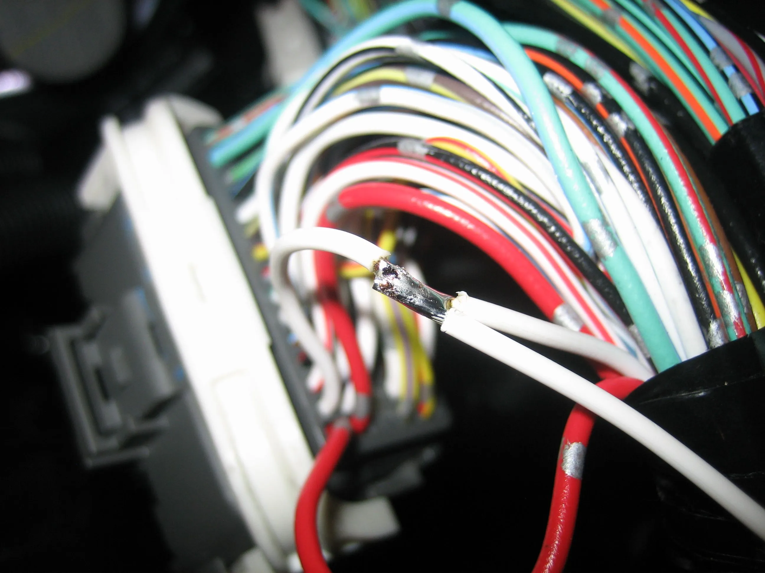

that is the same cheapie i bought. it works like a champ ! dont use those bad scotch lock things. peel the insulation back and solder that bad boy in there !
If you find the heat shrink version of T-Taps, they willl be ok. They are on ebay as well.
This is what a skinned and soldered joint should look like when finished.
-enganear
