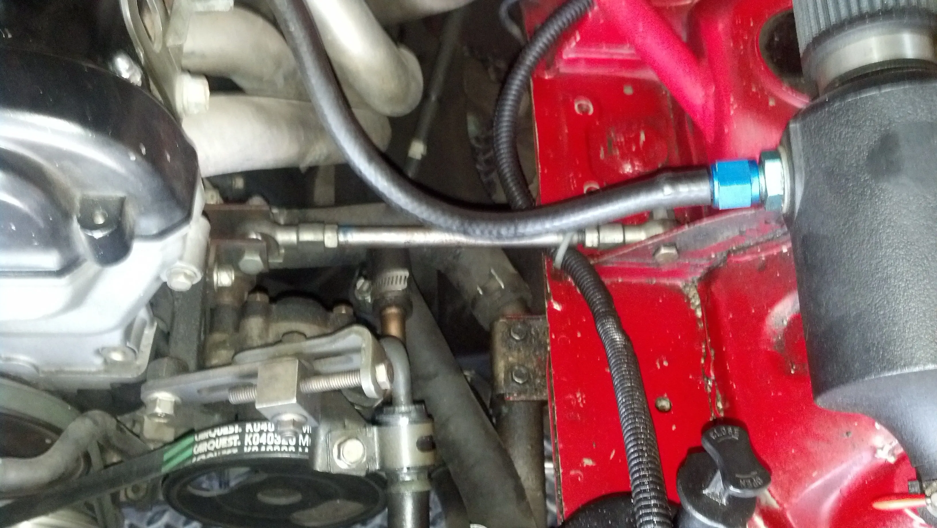

I also figured out why on my last run at Nationals I kept getting fuel starve...
Oops.

Do you have a "torque arm" or whatever you want to call it to keep the motor from rocking? This one is a threaded rod with heim joints at each end and a tube over the rod just for looks. Sometimes when we have to shift to third, I've been known to hit fifth :-( We have a fifth gear lock out on the shifter.
When was the last time you replaced motor mounts? Missed shifts is a typical symptom of one or both of those being shot.
Though a torque arm like that is an intriguing idea...
