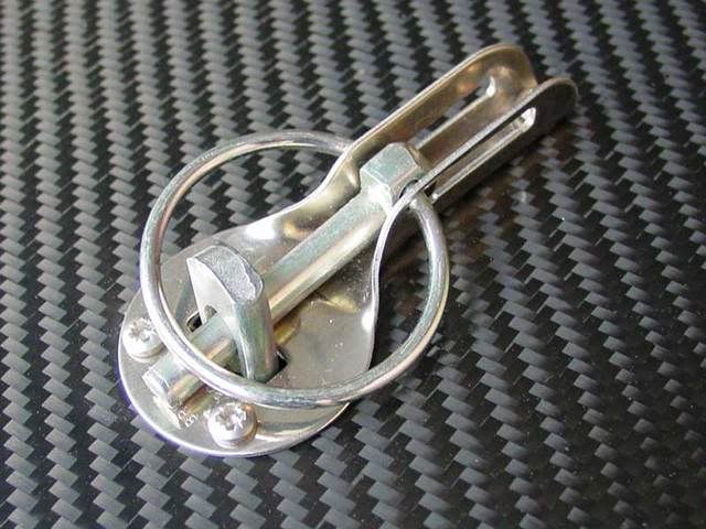

I finally found a style of 'hood pin' that I don't hate, and that doesn't cost a friggin fortune. I was planning on using the aerocatch hood latches, but they're like $120+ for a pair, so that wasn't ideal by any means, but it was better than most styles of hood pins. Don't ask why, I've just never liked the tethered or untethered kind, just seem too fiddley for whatever reason, too easy to lose parts or scratch paint with them.
Then I saw these on a Wayne's (apexlater) car this weekend:
They're captive, which I really like, and I save about $100 / set over the aerocatches, so these are on the way. 1 more weight reduction upgrade set :D (hood latch + catch + cable = outta here). Except in red, because I'm a closet ricer.
For anyone remotely interested, search e-bay for Sparco Hood Pins and you'll find these
